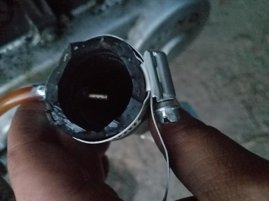

I got my small parts in so ill be doing some runs once im out of work. The longer intake in the picture made the clutch lock up slower, it was causing turbulance at lower speeds. I made a smaller version that is essentialy a big elbow to the carb with a filter on it. It ran alot better. The new filter i have has an hole smaller than the carbs inlet, when i ran it as it it bogged heavily like it was choking. i drilled out the inlet until it was able to achieve prior speeds. it runs the new filter without having to restrict the filter with tape. I have plenty of pics and if it doesnt rain ill try to upload a video of the power valve in action. once the carb is working properly i would like to start some trials and run it.

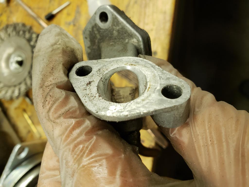

Thanks for the inspiration meatball! Got around to doing some porting for the reeds, I'm so picky about my measurements that every 5 seconds I pulled my dremel back to compare the reeds opening to the manifold with calipers. Needless to say I matched it up near perfectly. I also took a lot of material from the bend right after the carb. I ate into the back of the flange on the inside to make as nice as a transition as possible.
After a few silly errors I got it running and man does it have response. The literal moment you crack the throttle all you feel is a snappy response. With the jet needle at max rich, all my throttleage was within the 1/4 to 1/2 zone, anything after that it just made more noise. Now I know I'm very lean. I had a random #78 jet laying around so I slapped it in and felt much more torque. I didn't change needle setting( I should have) and it stuttered little at 15mph but after it kept rising in rpm. I topped out at 30 mph on stock 85 gears. I feel like if I lean it out to a #70 or #72 it will be right where i want it.
- Got it pretty even.
- rps20180723_201826.jpg (103.63 KiB) Viewed 9844 times
- rps20180723_201857.jpg (80.81 KiB) Viewed 9844 times
- rps20180723_201946.jpg (94.39 KiB) Viewed 9844 times

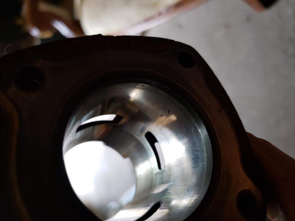

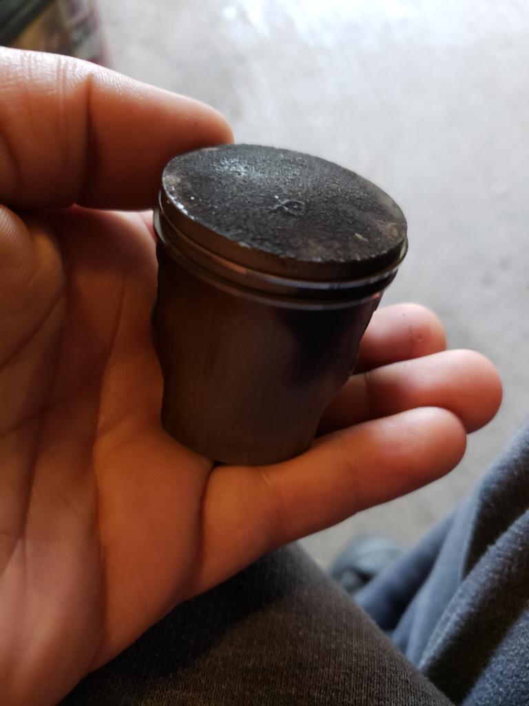

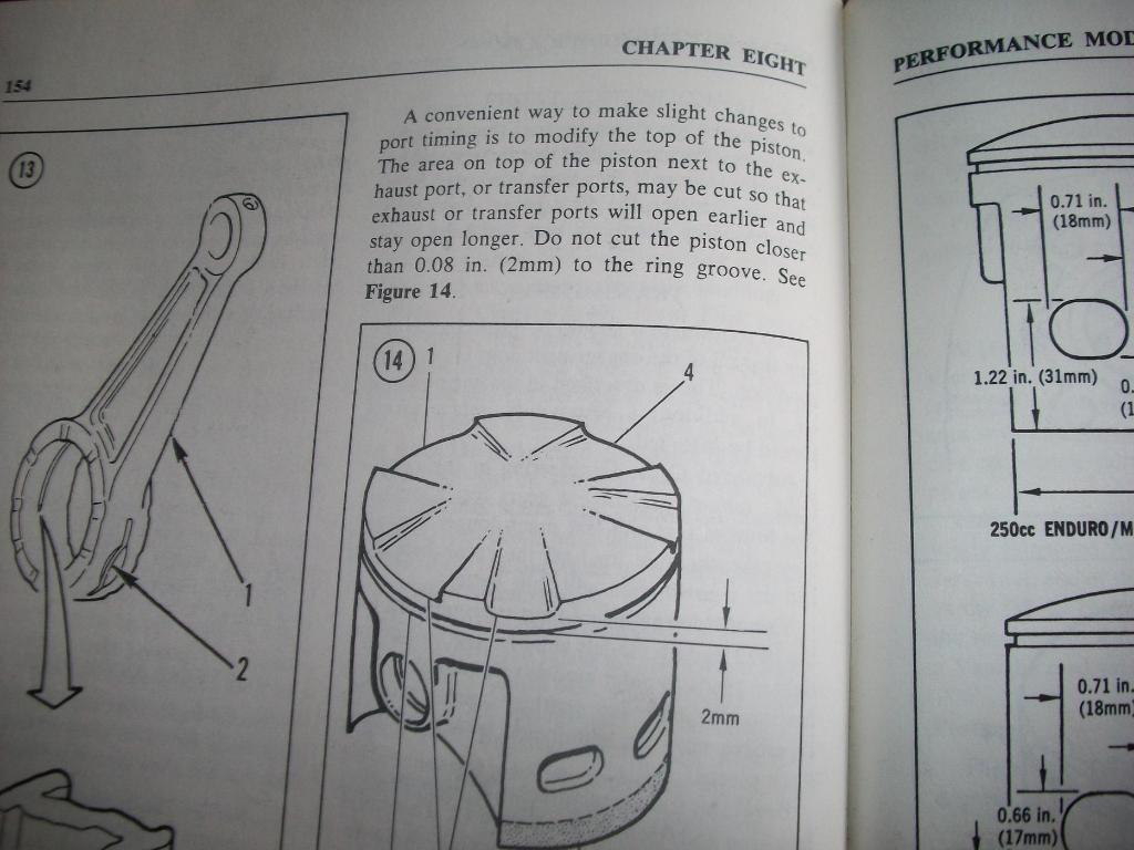

Just got my jug and piston in and they are in great condition. Paid 25 for everything, only downside is it's the 86-86 jug and domed piston so the ports are already raised higher than mine. However I will try to go as aggressive as possible with exaust port timing while keeping the intake and transfer ports times slightly less aggressive. If I raise it by 2 rings worth of metal it should free it up, but on my 85 I'll have to go up 3 rings worth of a little more to achieve the same timing but will flow more for that same reason.
I found a page in a Yamaha 2 stroke book online about small mods n such. On the plus side, the domed piston may help the cuts on the top flow better rather than cutting into a dished piston and it will raise my compression without cutting the heads(yet)
- Bore look good and feels smooth.
- rps20180725_160344.jpg (39.9 KiB) Viewed 9800 times
- Didn't realize how small it was, its adorable.
- rps20180725_160404.jpg (53.14 KiB) Viewed 9800 times
- Kind of a guide for how it should look, but aligned to the cylinder.
- rps20180725_160425.jpg (88.32 KiB) Viewed 9800 times
