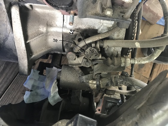

So I've run into another minor head scratcher. As I was putting everything back together, I was looking over the oil system and at the oil pump in particular, intending to zip-tie it wide open. I noticed that there is a cable that connects to the oil pump. This cable seems to move in sync with the cable connected to the carb when I twist the throttle.
Is this the "Y" cable that opens the oil pump farther with the throttle that is stock on the SR? I'm almost positive my scooter is an Elite S; even more so after rebuilding the carb and finding a #68 jet inside.
Regarding lubrication, should I remove and clean the oil strainer? The scooter has just over 5000 miles on it. If not, is it OK to mix synthetic 2-cycle oil with conventional? The oil currently in the tank is a marine 2-cycle oil, probably the cheapest available. I didn't buy it so I don't know for sure, but it sounds about right for my FIL.

Thanks Meatball. I looked at the sticker and sure enough it said SA50P. I snapped a picture of the throttle cable and of the pump. Is this the Y-type cable from the SR? If so, do I need to do anything to the pump to increase its output now that I've re-jetted and de-restricted the scooter?

You can look on the oil pump for the designation either GS7 or GS7V. Just wipe off the area shown in the pic I did. The "S" oil pump has the "GS7V"
The "SR" pump has "GS7"
If you have the "S" pump I remember someone suggesting to add addional oil to the fuel tank at about 100:1 ratio to compensate. You can search the forum for the thread but I'm pretty sure that's what someone had suggested. I would keep the split cable and keep an eye on the spark plug color. :thumbwink:

I cleaned off the spot and it is the GS7V, so the normal pump for the Elite S. I'll probably just clean the oil strainer and add an ounce or so of oil to the tank when I fill up, unless I don't need to because of the split cable?

I belive what Bones is saying is that the ÔÇ£SÔÇØ and ÔÇ£SRÔÇØeach came with different unique oil pumps which deliver oil at different rates. That being said, your Y cable operating the pump wont do jack unless its used with the correct pump. If your pump is from an SA50p model and someone simply added the Y cable to it...youd need to mix 100:1 in the tank. If you have the pump from an SA50 (and the Y cable attached)...you do not need additional oil in the tank. Investigate on which pump you have.
Honestly, I dont recall the actual flow rate of each pump nor do I remember if the SA50p oil pump actually had varible flow when a Y cable was added. I seem to have a vague recollection of the swing arm on an SA50p oil pump to have no actual function in any position. I think that pump flows at one rate only. Someone please confirm.

Per the info from Bones, after cleaning the plate off I can see it is marked as the GS7V, the "S" pump. I'd love to know for sure if the "Y" cable actually does anything on the "S" pump, that would help me know if I need to add any extra oil to the gas. I know too much oil is not good, but I'd have to imagine it's better than too little.
