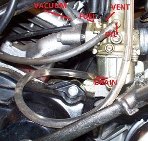

So this weekend I put the carb back together all ready to go, re-connected it and put a little gas in the tank. Did not attempt to start it but gas came flushing out the air vent tube for a few seconds and then it drained out the overflow on the bottom of the carb. I undid the carb bowl and the new floats and needle all looked good. Is it possible I hooked it up wrong? I can take pictures of each connection and each hose if someone will help me be sure I did it right. Due to parts taking forever to arrive it had been more than a month since I disassembled it all so I might have made a mistake. Any help would be awesome.

Could someone look at this picture and tell me what goes where?
Float level checking RESIZED.jpg (57.1 KiB) Viewed 10506 times
The vacuum line is for a vacuum actuated fuel petcock

Bones,
Thanks for the pic! So my oil line has a steel tube inside the hose that will not fit over the carb inlet for the oil connection. What would you do with that issue?

by btosi
Remove the steel tube from the hose. It is most likely a piece that broke off from the previous carb.
