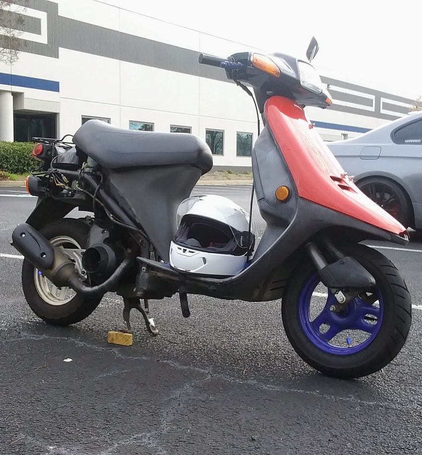

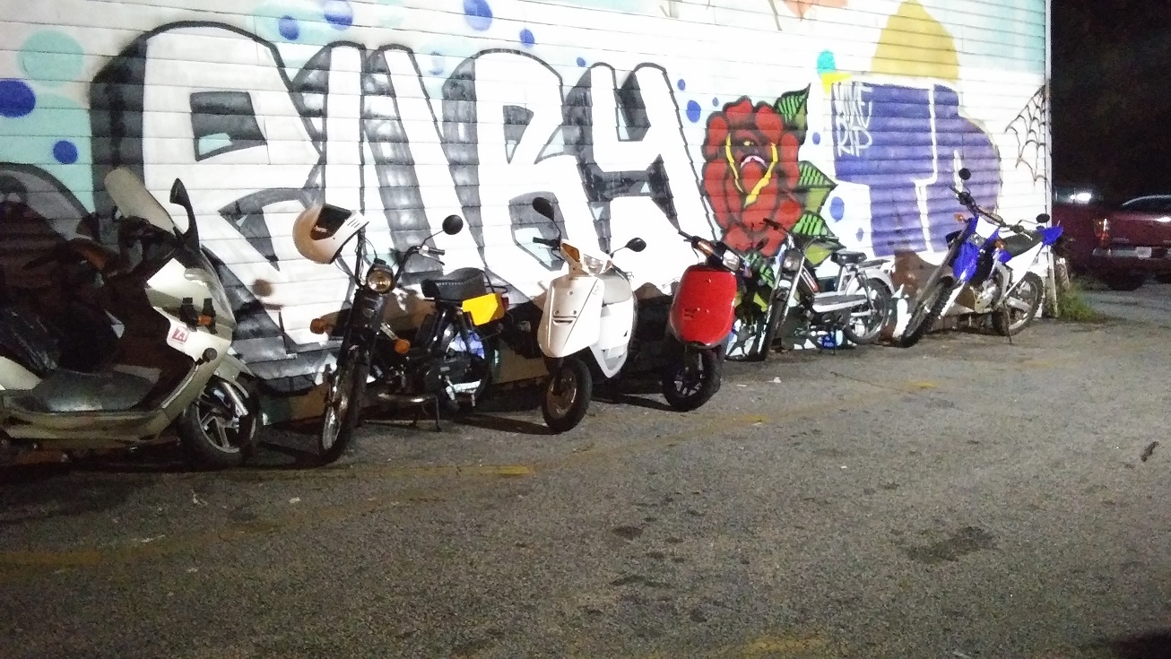

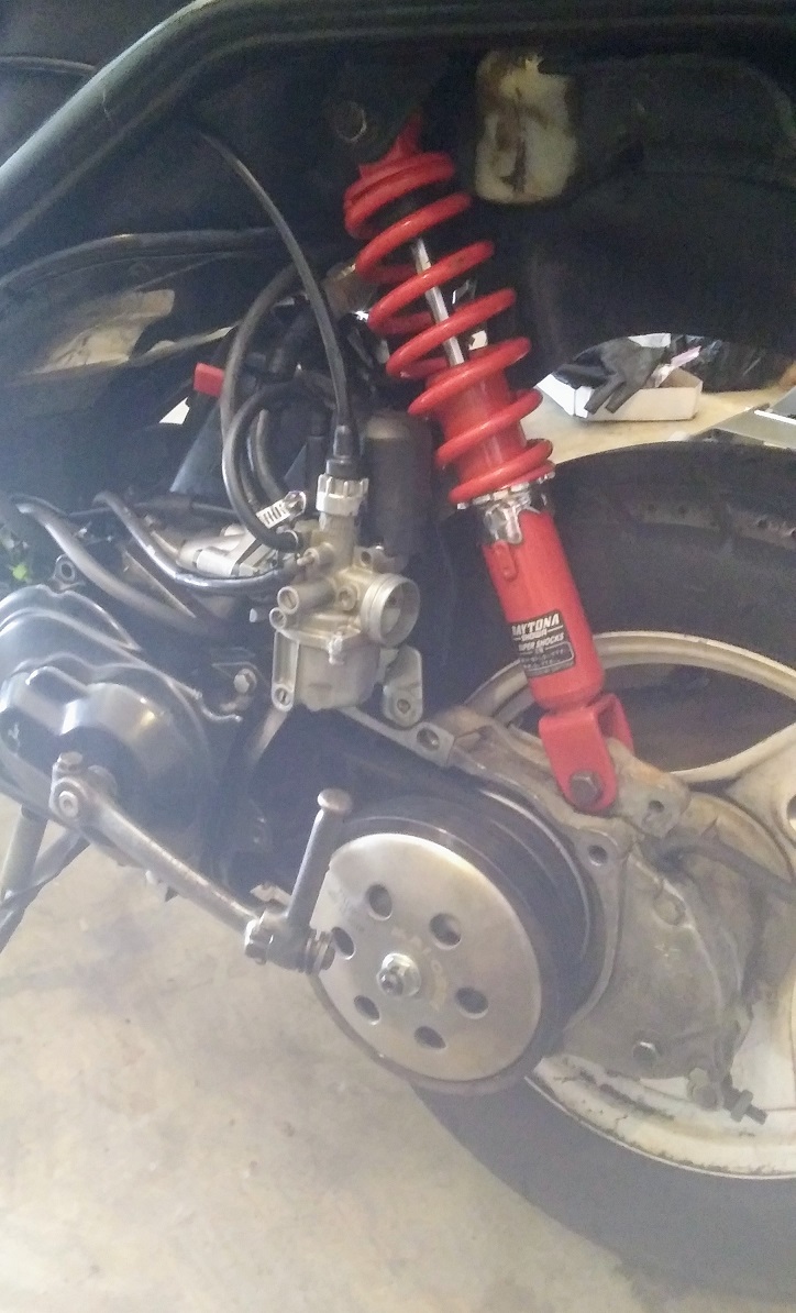

Some pictures, as promised! She looks quite a bit different than at the start. Never liked the purple panels much personally and sold those on a spare bike. She's black, red and blue now heh. Don't mind the external throttle cable.. lol maybe alludes to the "Stage 3" setup, which is planned for later this spring! It will complete this project, and I look forward to it :twisted:
Found a cool group of moped riders local to me here in Atlanta and been riding with them since last fall! Fun times :D

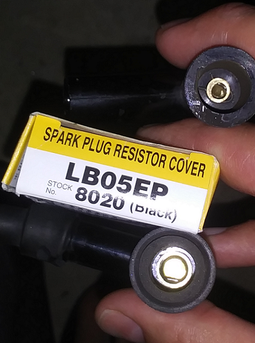

First up, after 2k+ mi on the Stage2+ setup, the OEM sparkplug cap started giving up the ghost. The OEM ones do suck over time, especially when running upgraded bore with more heat and power. It's a pain when they pop off mid ride, but luckily an easy fix!
I used to upgrade to NGK equivalent L-type plug boots. These were a step above OEM, but would still fail with extended long term riding. My new favorite, is upgrading to an NGK LB05EP (#8020). It uses a stud/bulb style automotive type connection which is superior in reliability and long term use to the stock threaded type. See below for comparison, not how the OEM upper just the tang to hold onto sparkplug thread, while the bulb type below will cover much more surface area = better connection! An added benefit, I saw approx .5hp gain due to the better spark!! Was not anticipating this, but butt dyno says its there, no complaints :)
Sadly the LB05EP has been discontinued.. If you can find one, highly highly recommend snagging one. From ebay, etc. There are similar options for a stud/bulb plug cap from malossi and polini, but cost more $$. Amazon has some china-generic versions of the LB05EP for cheaper, but they appear less quality than NGK. Can't comment on if they will be as reliable, but may be worth trying.

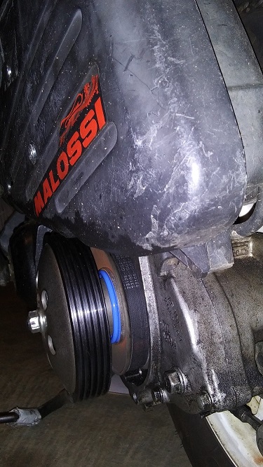

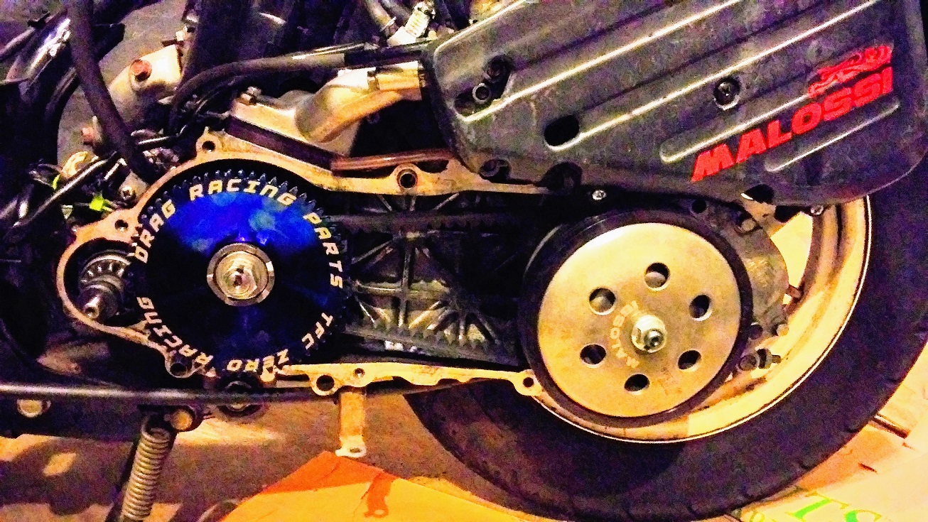

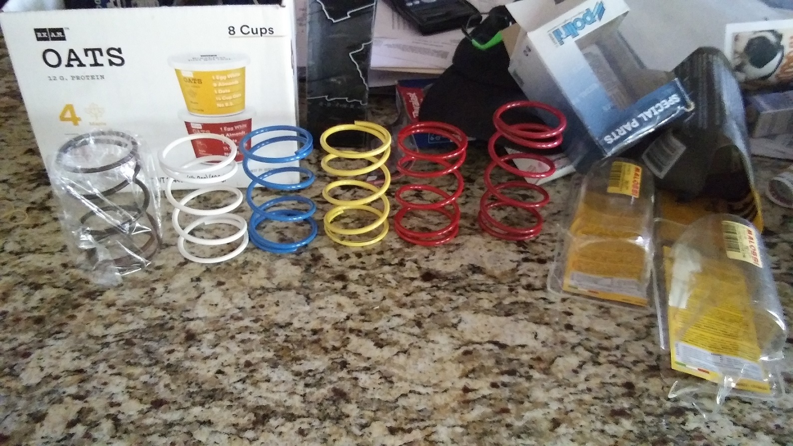

2nd mod, was long overdue: I finally upgraded the stock rear clutch pulley center spring! I ran the stock one for a while, for science, but approaching 3k mi on this setup the stock spring had fatigued and would heat soak on long WOT stretches. Which would = sooner upshift and lazy downshift, or no downshift at all which made the scoot feel like a dog. Basically not using the CVT, as intended.
Had several center sping options to choose from. The polini white was too soft, softer than OEM. Usually do the malossi red for higher power builds, so was leaning towards the malossi yellow. But instead decided to try the polini blue. And it is a great match!! With front pulley setup unchanged, same wt. roller weights (51.4g). The CVT functions fantastic and shifting is restored! Launch is better. Roll on mid is better. And top speed is still GPS'd at 60+. Quite pleased :mrgreen:
Note: I retained stock clutch springs, only center is upgraded. Due to the aggressive gearing for launch and to prolong stock clutch pad longevity, didn't see a need for this setup rev up high from a stop. Not dissappointed in this choice, launches are still boogie strong!
