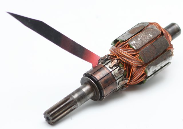

Here's an armature which had 3 problems, one was fatal
1) Commutator segments are full of brush dust and debris.
2) Windings insulation burnt
3) Shorted coil in armature. If the shorted coil was in the right position, the motor would not start
If the shorted coil was in any other position the motor would run, but slow.
When the motor did run, the starter motor got toasty hot.

Commutator Cleaning
Use something which fills the slot and will be kind to the copper to rake out the debris.
In the photo is a piece of plastic blister packaging. Polish the commutator
Give the brushes a fresh smooth, clean surface by polishing the commutator.
I used 320/400/600 grit on the drill press.
The references below show 320 as the finest grit resurfacing products they sell.

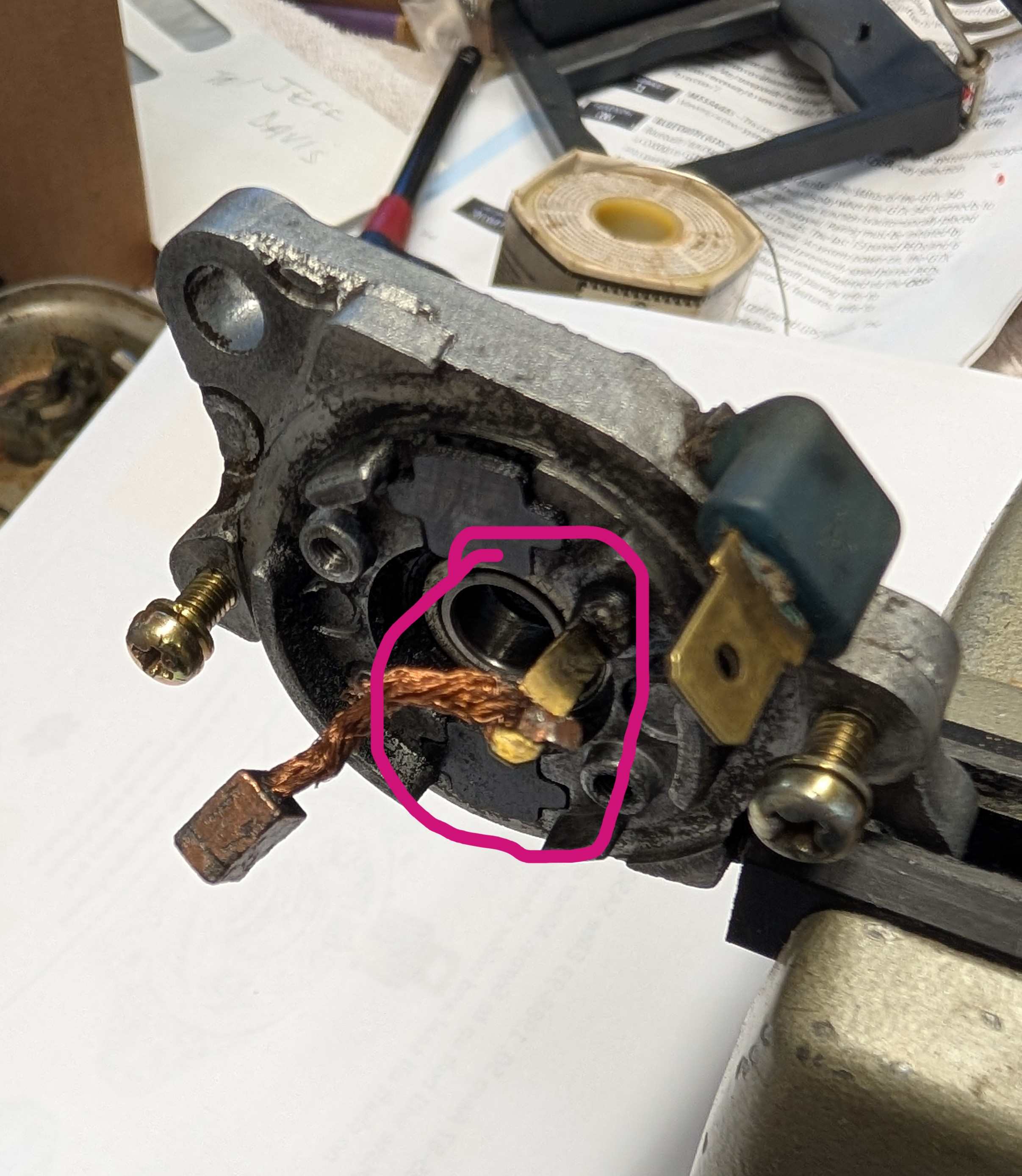

I know this is an older thread, but I hope @mousewheels, or one of the other contributors can help.
I bought replacement brushes in the form of the Suzuki LT starter brushes, and am trying to install them to my starter terminal plate.
The "plus" terminal brush is attached to a copper blade post and the "minus" brush is attached via a ring terminal.
I thought the plus lead was soldered to the copper blade, and I have tried to de-solder it with both a hot iron, and when that didn't work, with an butane "pencil" torch.
Neither would budge the lead from the copper post. I now suspect the lead is ultrasonically welded to the post.
How have folks attached the new brush lead to the copper blade post? I am thinking of just cutting away the old lead and soldering the new lead to the post?
Any suggestions or solutions appreciated. Thank, Jeff
