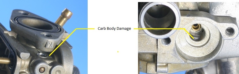

1) Check the carb body behind the carb mounting flange closest to the bystarter for a dent from a 'too long' bolt
If there is a dent, pull the bystarter and see if the carb body has internal damage
2) Make sure the brass fuel pickup tube for the bystarter is fully seated in the carb body
Edit - add photo
