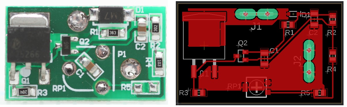

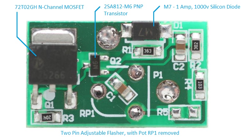

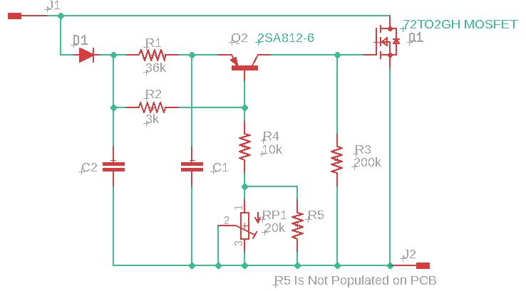

Major Component Identification
Schematic
The board layout and components look completely different from the Fixed flasher torn down earlier.
However, comparing schematics, the boards are very similar in design.
Schematic - PCB Check
Waiting for parts to arrive gave time to check out the schematic.
If the schematic is correct, then laying out a PCB should re-create
a board resembling the original PCB.

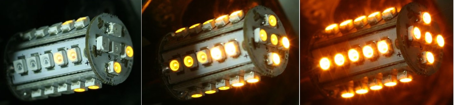

LEDs
Here's what has been tested:
  • The Tail/Stop lamp is out of scope for the Flasher test. Notable is it's seller spec'd 5v-24v operation.
  • To my eye, the right most T10 lamp was the brightest, followed by the White LED. The Amber LED in the center is the weakest.

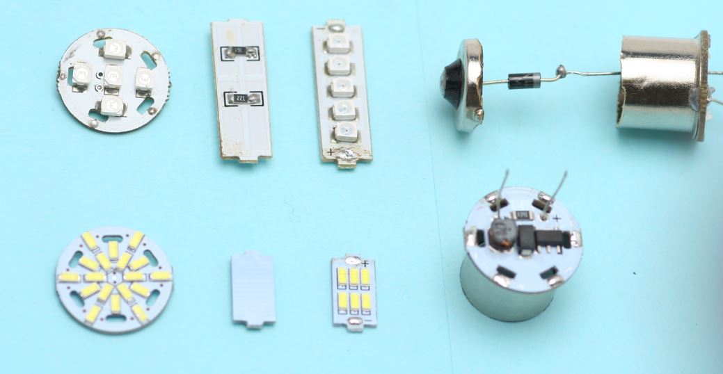

Lamp Teardown and parts ID
  • Amber LED with resistor current limiting (Top row)
  • White LED with Switching Power supply
Amber LED
Amber Led has a single diode on the center pin of the LED. That is a reverse polarity blocking function. If the
bulb is incorrectly wired or the battery is reversed, the LED will not blow up. It just will not light
There are two resistors on the rectangular LED panel as well as the round board which is on the top.
White LED
There are no current limiting resistors on the LED boards. So all current limiting is contained on the round
power supply board.
The LED's are arranged as 3 LEDs in series. Each block of 3 LEDs is then placed in parallel to the power supply.

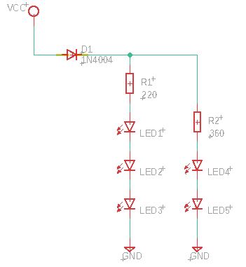

Re: Electronic 2 Pin LED Flasher Test
Posted: Sat Jul 23, 2022 3:57 am
Amber LED Schematic

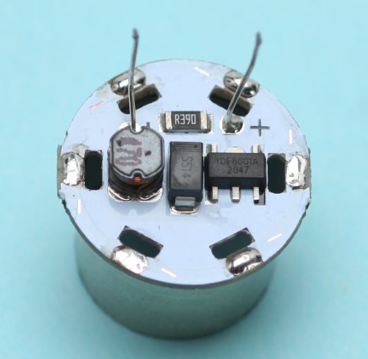

White LED Component id
  • Top - R390 -- 39 ohm resistor
  • 9 o'clock 470 -- 47 uH inductor
  • Center SS14 -- High speed switching diode
  • 3 o'clock YDE8001A -- switching regulator IC -- data sheet not found
  • Top -- Bridge Rectifier
  • Bottom -- Capacitor

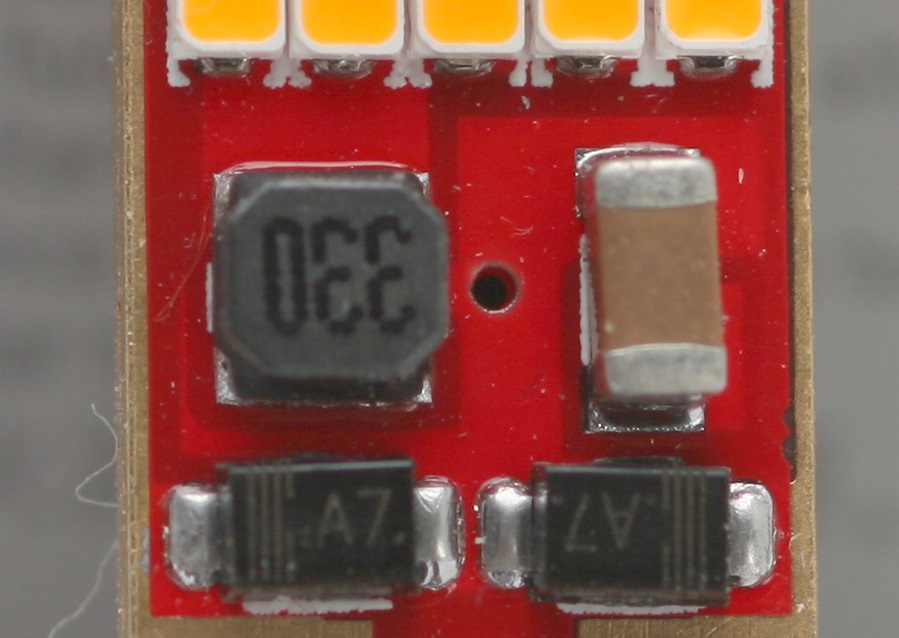

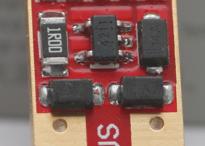

Component ID T10 LED (the tiny Amber LED in prior photos)
PCB Top Side Components
  • Top Left -- 1R00 -- 1 ohm resistor

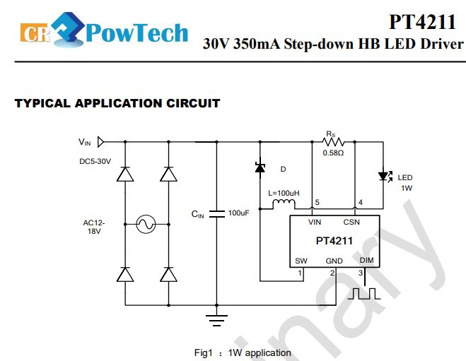

  • Top Center -- 4211 Switching regulator IC -- Datasheet found - sample schematic will follow
  • Top Right -- 14A -- high speed switching diode
  • Bottom components -- A7 -- general purpose diodes -- part of input bridge rectifier
PCB Bottom Side Components
  • Top Left -- 330 -- 33 uH inductor
  • Top Right -- Ceramic capacitor
4211 Power supply IC typical application
The components on the LED have different values than the diagram. If interested search the 'net for the
full datasheet - there is some design info.
