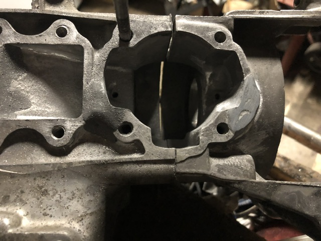

I have never seen a lead in person but I have learned a fair amount about them in my searching for 83-84 ab07 aero performance. For the engine mount. Search what others have done to put a dio in a first Gen aero. I actually modified a set of ab07 cases so I could port match a lead af01 big bore on it. They are both. 40x39.3 bore/stroke. With the plastics off they are very similar. As to your wheel problem. You can stack washers behind the hub on the axle as spacers to move the wheel out a little. Or equal amounts of washers on the 3 studs that attach the hoop to the hub if you need to move the wheel towards the frame. If you’re not building a stroker dio. I’d recommend building the af01 your lead came with. Metrakit, pinasco, and a few others make big bore cylinders for the af01. And the af01 has same size ports as a dio. I think that’s where Honda copied the dio port map from. The lead is one of the oldest and the begining of the AFxx family of engines. For exhausts the dio race pipes fit on a lead if you cut the flange off twist 90* and weld it back on. The zx rear pulley and bigger clutch and the larger overrange dio variator fit in the cvt with some case grinding to clear both of those modifications. And for the variator boss. You or someone with a drill press just needs to drill the boss out to 20mm so it’ll fit the af01. Cool bike. Can’t wait to see what the finished product turns out. Here’s my 84 aero with jdm tact glove box and lights. It has an AB07 case with a pinasco bbk made for a lead, a dio pipe I modified and turned into a side bleed, stage 6 intake with24mm mikuni carb and all the cvt mods I just explained. It rolls on jdm alloy wheels with a elite 150 front hub (120mm brake) and a ruckus rear hub (90mm brake) and 90/90- tires. I’ve had it over 60 mph on flat ground and I weigh 190. And it’s got a cig lighter Bluetooth stereo and under lighting.
harleyracer59
Posts: 258
Location: Nickastan ca
Re: Honda Lead NH50
Post by harleyracer59 »
Modified ab07 cases to fit af01 lead bbk
