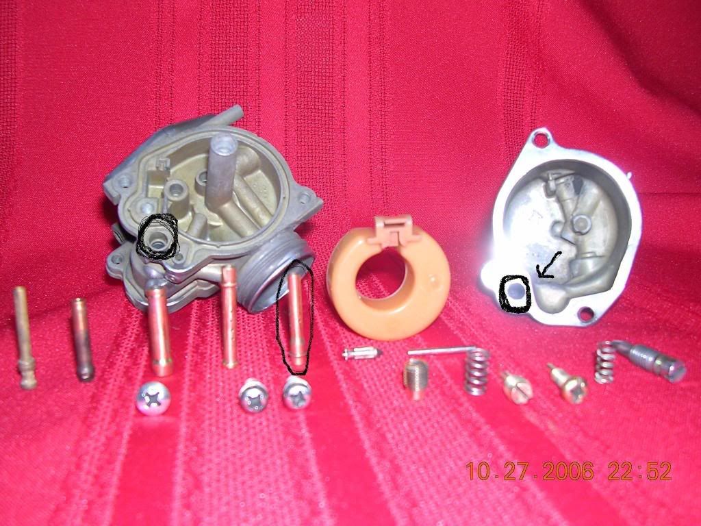

cold start circuit
if you remove the float bowl, look right under the by-starter.
There is a tube that projects into the bowl.
This tube can be removed by tapping it from the underside. It is then going to pop out from the top of the carb. You will see little air jets drilled into this tube. Make sure they are clean.
On the bowl side, (circled) there is a port that this tube fits into. And in this port there is very small fuel inlet hole (arrow). This must be clear! If you suck on the top of the bowl (circled), where this port is, you should draw air if the hole is clear.
This is the cold start circiut, that is seldom mentioned anywhere.
