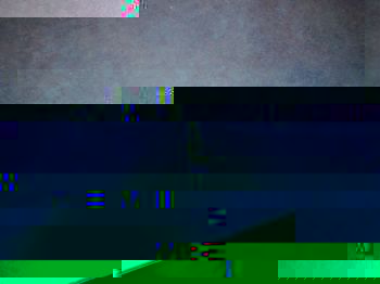

Like this?
- phpxp9RRJPM.jpg (10.72 KiB) Viewed 5738 times
Re: PLEASE HELP!!!! [Resurrecting 1987 SE50 Elite -Ed.]
That looks like a crushed brass standpipe alright. However the pic quality is clearly better than any I have taken.
