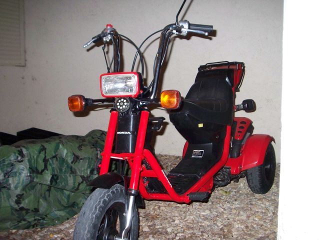

Re: Gyro - general thread

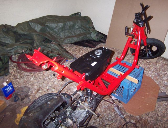

OK only major problem ...Petcock.
I really think everything else is done
rear tire still leaks air .

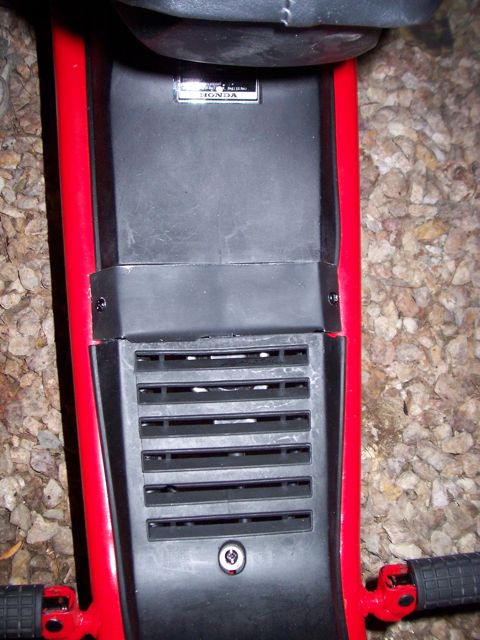

OK also will look for something to cover up hole in fender ( I have a idea that will work and look cool )
As for the front cover don't ask .( It looks fine )

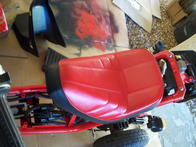

I am sure your seat will be ready by or before Friday .
Floor plate  / done
Floor plate / done

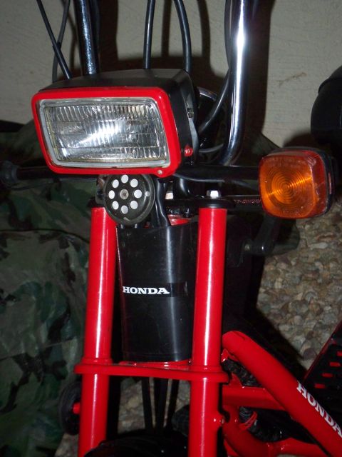

front cover / done
front cover / done

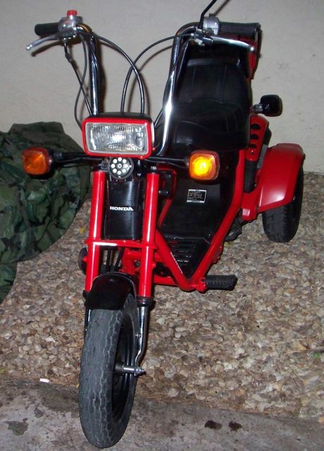

more pics / so close petcock need working non-leaking petcock Then done done done....
Get on your bike and ride .
Oh yea a speedo gear

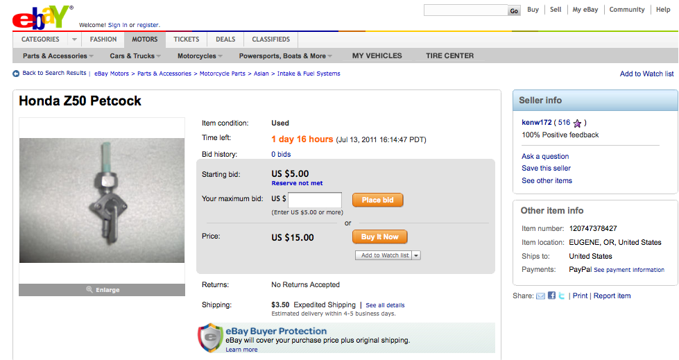

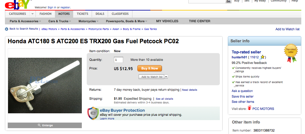

OK you will have to check the size . but you need to find a petcock ...
Thats It 1 petcock .... DONE !
Again I do not know if these will fit but you need to find something ...
Screen shot 2011-07-11 at 11.14.28 PM.png (155.61 KiB) Viewed 27933 times
??? might then again might not ???
Screen shot 2011-07-11 at 11.22.06 PM.png (211.86 KiB) Viewed 27933 times
might be too small ???I don't know
Screen shot 2011-07-11 at 11.22.49 PM.png (177.53 KiB) Viewed 27933 times

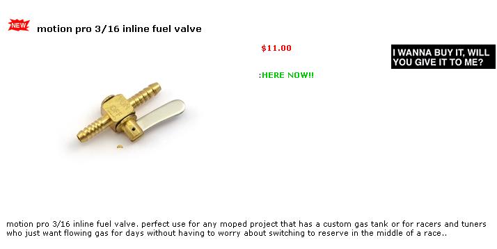

On the petcock end - I've tried the ATC and z50 petcocks, their thread is too small.
I think what we want is 16mm x 1.5 thread on the petcock, but check you tank to be sure.. It's the same thread as the bigger vacuum petcocks like on an Aero/Spree and possibly the SA50. One fall back I have in mind is to tap the intake and try the vac petcock. It would solve the parts problem... but there is no 'reserve' position :nervous: :) :)
== Another idea ==
Gut the petcock and remote mount something. Here's one from treatland (I've not bought from their shop before). Again, there's no reserve. Just carry a flask of petrol :P .
mousewheels wrote:On the petcock end - I've tried the ATC and z50 petcocks, their thread is too small.
== Another idea ==
WOW Thanks so much , I have been on google for hours and possiably have found some replacements . So thanks again for pointing me in another direction that could actually help .

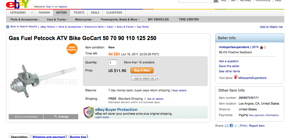

I actually ordered the one on eBay you listed first. Looks like it will fit. I ordered it when I got home sunday. I will let you know if it will work.
taz

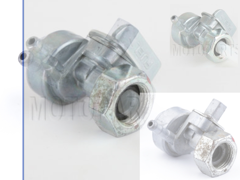

Hey taz - Here's results of photo's from a Gyro petcock and some of the seller's photo's for their petcock... sure looks promising, but you will be the first to know :lol:
Top right - seller's photo,
Bottom right - OEM Gyro petcock - a little big compared to sellers photo
Left - size adjusted composite

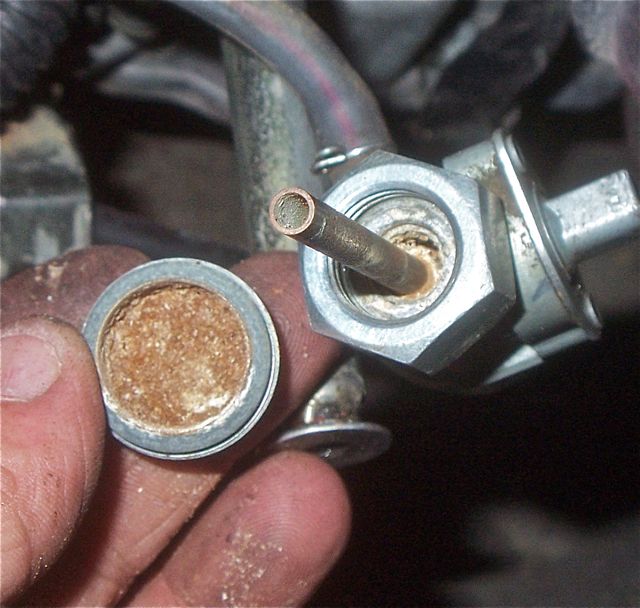

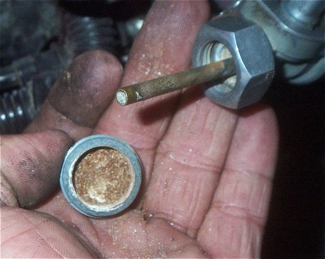

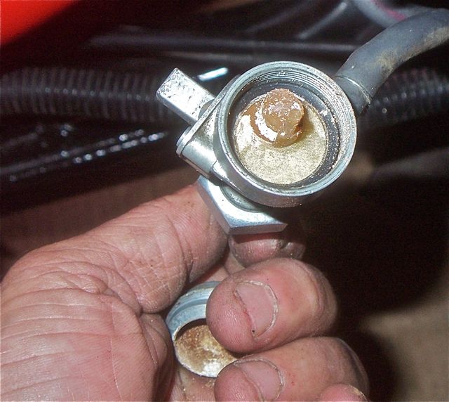

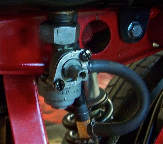

NO WAY ...
NO FU@KING WAY ...
YOUR NOT GOING TO BELIVE THIS ... I THINK YOU MIGHT HAVE TO ORDER ANOTHER PETCOCK ?
Everything was going fine .
I thought I would check my petcock .

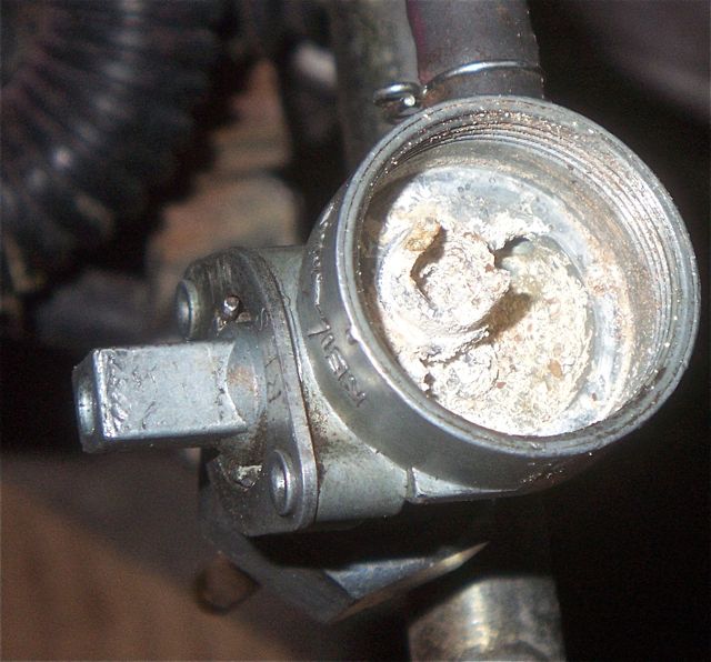

NO WAY . this cannot be happening .

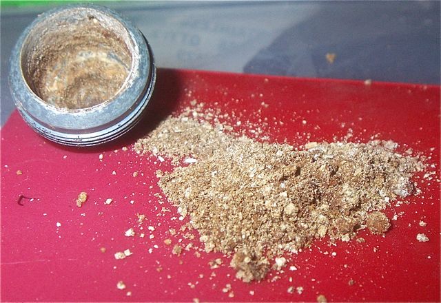

This is what came out of it ...
It was like powdered gasoline .
I was going to see it it would light on fire but I was so * I just threw it out .
I can't belive this .

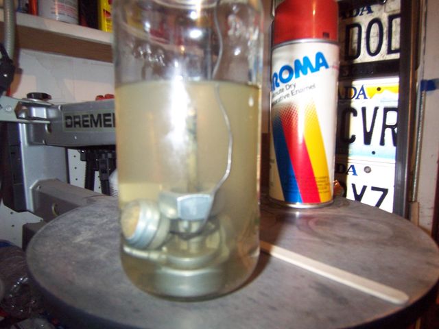

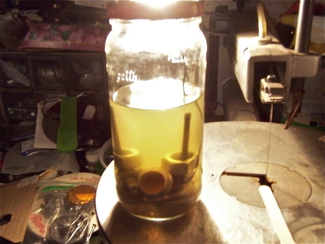

I am soaking my petcocks in gasoline overnight and see what kind of condition they are in tomorrow .
I will try to find a rubber washer or grommet and see if I can re-build yours tomorrow to see if I can stop them from leaking .
This sucks !
But I do have a kinda funny story when I was looking for a jar to soak the parts . Tazz make sure and ask me about the jar ...you'll laugh .
actually looks like the shet  is dessolving
GYRO CENTRAL  no petcock no run

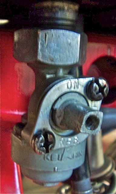

OK got a petcock to work I will try to work on 2 more but don't hold your breath they are very plugged up.
Had to drill out rivits and tap petcock
gas in tank not on floor
No leaks
No leaks

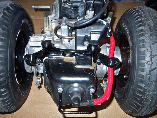

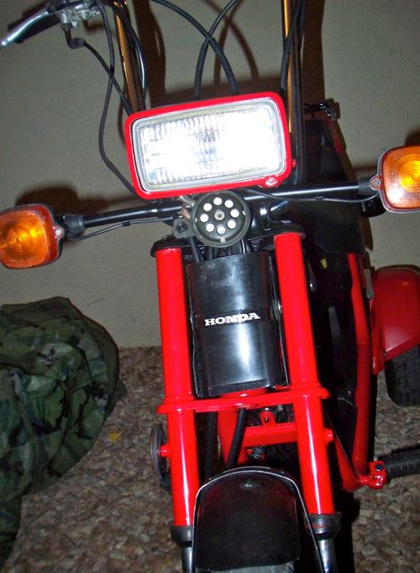

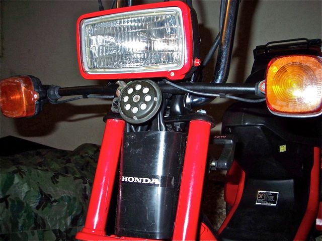

2 tone headlight cover
Re-painted seat w/ vinyl paint / really looks great
Engine cleaned & running great .
