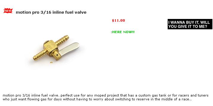

On the petcock end - I've tried the ATC and z50 petcocks, their thread is too small.
I think what we want is 16mm x 1.5 thread on the petcock, but check you tank to be sure.. It's the same thread as the bigger vacuum petcocks like on an Aero/Spree and possibly the SA50. One fall back I have in mind is to tap the intake and try the vac petcock. It would solve the parts problem... but there is no 'reserve' position :nervous: :) :)
== Another idea ==
Gut the petcock and remote mount something. Here's one from treatland (I've not bought from their shop before). Again, there's no reserve. Just carry a flask of petrol :P .

Hey taz - Here's results of photo's from a Gyro petcock and some of the seller's photo's for their petcock... sure looks promising, but you will be the first to know :lol:
Top right - seller's photo,
Bottom right - OEM Gyro petcock - a little big compared to sellers photo
Left - size adjusted composite
