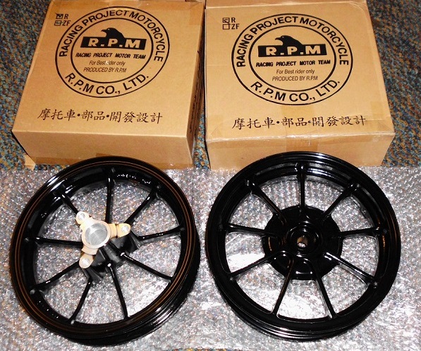

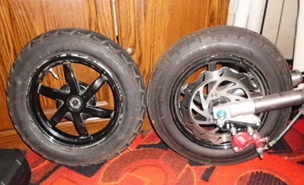

after 5+ months the rear rims arrived
pre ordered from jiangwayne.com july 24
received front rims sept twenty something
jiangwayne had a problem with rears wrong spline count
that is why it took so long to get rears
when I pre ordered and saved $ 21.00 on each rim 84.00 total
and a break on shipping so it was worth the wait to me
Part numbers front has 12 mm axle
RPM 10"x2.15J Front Wheel (Dio TDM, Black) - 44650-GW0-R02B
RPM 10"x2.15J Rear Wheel (Dio, Black) - 42601-GW0-R02B
was going to use the rims I had but like the looks of the straight spokes better

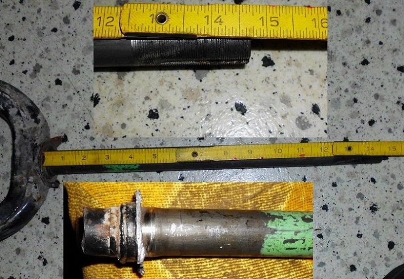

steering stem 14.75 inch from bottom of race to top
2.0 inch of full thread 2.25 inch counting partial threads
will edit later for thread pitch diameter and bearing race diameter ect
the bottom part of pic is what the stem looks like after you cut the forks off

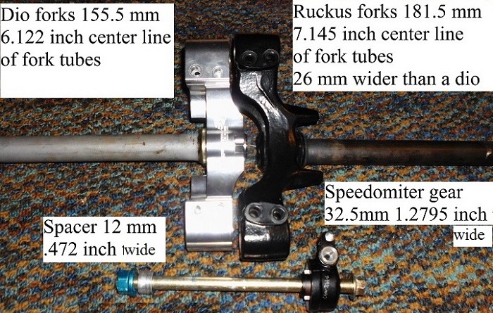

Dio style with 12mm axel / Ruckus triple tree comparison
so if you use a ruckus triple tree the spacers would need to be 13mm wider on each side
to keep the rim centered
45.5mm 1.791 inch total on speedometer side
25mm .984 inch on other side
dio style with 12mm axel triple tree stock spacers
32.5mm 1.2795 inch total on speedometer side
12mm.472 inch on other side
I would assume the 10mm axel forks have identical spacers

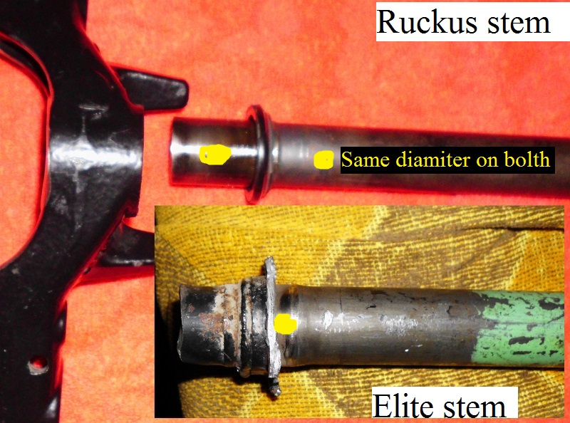

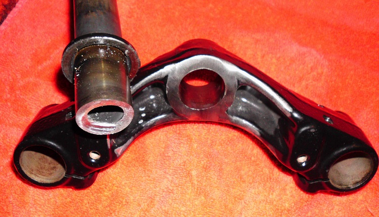

so if you mill / grind the weld off the bottom of the ruckus tree
and push the stem out
the hold diameter is the same size as the elite stem
so if you can get the weld off the elite stem
push it into the ruckus stem
re weld the bottom (and maybe drill and a plug weld on side)
you would be good to go

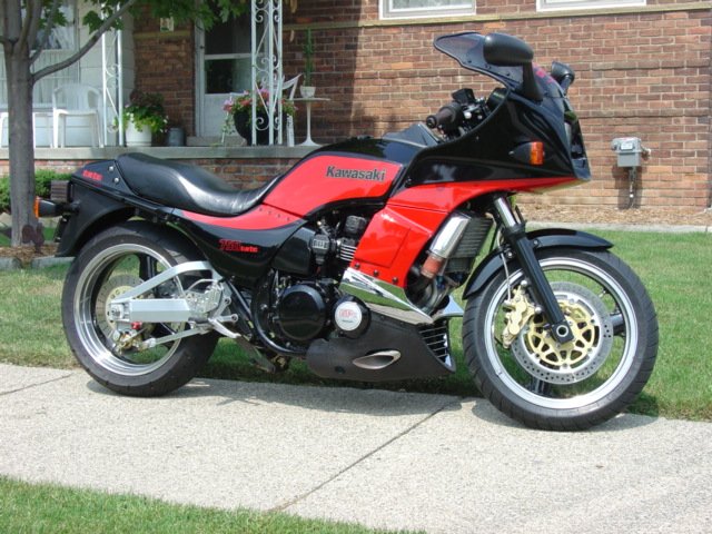

here is my first fork swap
1984 Kawasaki 750 Turbo
with 2000 Kawasaki zrx 1100 forks and custom stem
Suzuki Hayabusa swingarm with a Kawasaki rim ,r6 handlebars
and many other mods that i performed
which is still in my possession

What are the 6 spoke wheels from. I'm curious as to what wheel choices I'll have in the future. Thanks

That ZX 750 Turbo is a true gem.
The boxes for the rims say "For Best Rider Only". Gotta love those Chinese translations. :)
Posted: Mon Jan 12, 2015 2:56 pm
by cruzingratiot
Wheelman-111 wrote:Greetings:
i was waiting for someone to see and comment on that "For Best Rider Only".
Thank you i have alot of time in it
willburr76 wrote:What are the 6 spoke wheels from. I'm curious as to what wheel choices I'll have in the future. Thanks
the 6 spoke are honda dio style
or aftermarket
KN Planning MODEL : WH17
http://japan.webike.net/products/21357113.html
