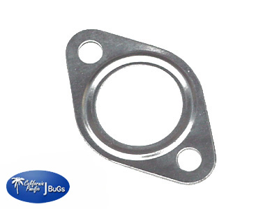

As long as you have a big bore, and a big exhaust, go snag an exhaust gasket from an old aircooled vw bug.
Re: My 2001 elite 50 build-up
That's an awesome tip!808BMW wrote:As long as you have a big bore, and a big exhaust, go snag an exhaust gasket from an old aircooled vw bug.
