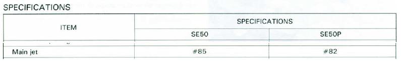

I'm sending a carb and throttle cable to martynkim. Anyone know why my SE50P carb comes with a #85 main jet but the SE50 comes with a #82 main? Is it because of the restricted exhaust?

Re: PLEASE HELP!!!! [Resurrecting 1987 SE50 Elite -Ed.]
Could some P.O. Have swapped jets? Stock on a lot of "P" models was 68.
- Posts: 3487
Maybe the p/o did some de-restricting and upjetting - or a swap to a SE50 carb?I'm sending a carb and throttle cable to martynkim. Anyone know why my SE50P carb comes with a #85 main jet but the SE50 comes with a #82 main? Is it because of the restricted exhaust?
The Service manual says its an #82 on the SE50P... Carb tag is PA31D for the 50P, PA31 E for the non-restricted.

I just got in my replacement jet. I can't tell you what # it is but here is the P/N 99101-1870820
"0820" = 82.
"0820" = 82.

So, I should use my new one
Funny, i look on cyclepartsnation and it's switched around...se50 = #82 and se50p = #85. My carb is off an se50p and has the #85. martynkim got a replacement jet and it's a #82? I can't check the carb tag, it's in the mail on the way to martynkimmousewheels wrote:Maybe the p/o did some de-restricting and upjetting - or a swap to a SE50 carb?I'm sending a carb and throttle cable to martynkim. Anyone know why my SE50P carb comes with a #85 main jet but the SE50 comes with a #82 main? Is it because of the restricted exhaust?
