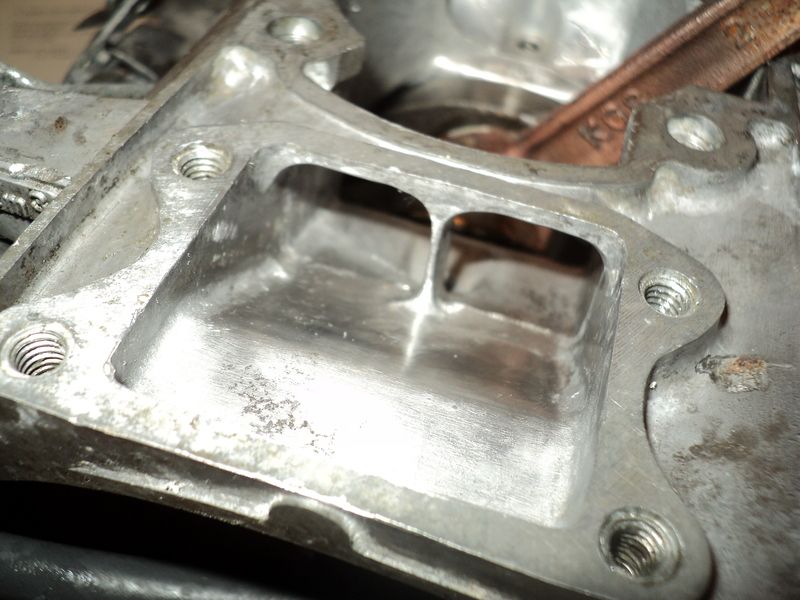

Opened up the intake window a bit. Before:
After:

Are you gonna split the cases :nervous: you could of got metal shavings in the case with the crank.

MrJumps wrote:Are you gonna split the cases :nervous: you could of got metal shavings in the case with the crank.
I only wanted to port the intake window so I masked off the crank case with duct tape. Then used modeling clay to completely block everything off, forced the clay to form into all the contours and more duct tape on top of that. When porting I also had my shop vacuum going to collect shavings, none got past the clay. Might be unconventional but it worked, saved me the labor of splitting the cases.

Okay making sure you blocked it off, okay good idea saves work.

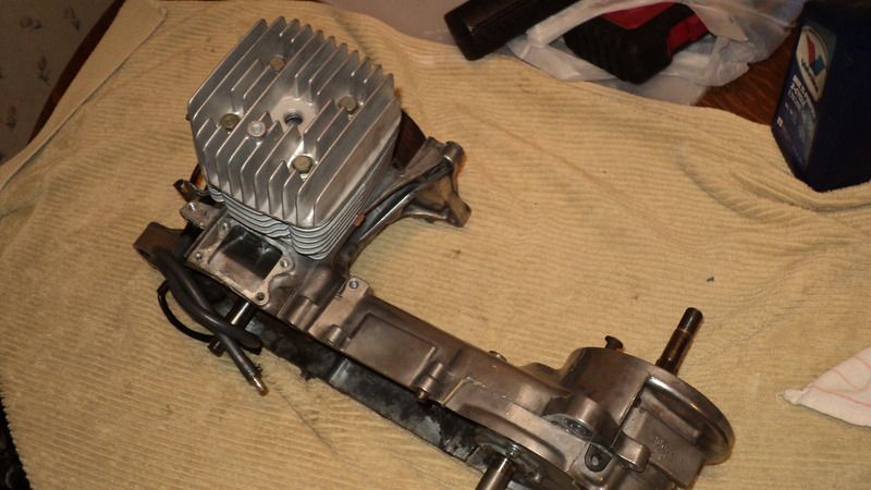

Final assembly of the nh125, probably won't get around to running it until summer.

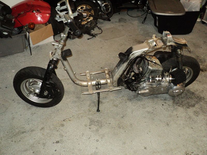

The next phase of my spree project is a complete paint job, been planning this for awhile now.
I've all ready started disassembly, going to start paint work on the frame.

From one spree swapwd owner to another rest in pepperoni. Lol looks good, get that mount good and strong.

MrJumps wrote:From one spree swapwd owner to another rest in pepperoni. Lol looks good, get that mount good and strong.
She's been good and strong since I did the swap over 5 years ago. I did improve the motor mount a couple times, had issues with the rubber dampeners getting melted when I welded the mount. I replaced the rubber with hard urethane but there was too much vibration from the engine. Eventually I went back to rubber mount dampeners and it's been good since.

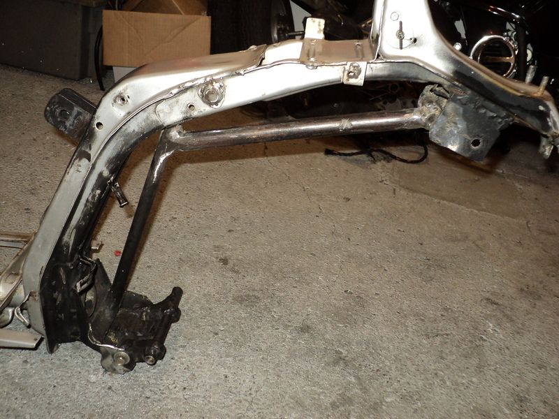

I decided to weld in one more support bar from the shock mount tying it all together.

Tyler VR wrote:I decided to weld in one more support bar from the shock mount tying it all together.
True art right there!

I bet thats solid you should also weld a bar from the base of the seat to the handle bar tower like an drag bike. Wish I coukd weld, but im not imaginable enough to make anything usefull. I would weld stupid s*** on to my spree like a ball hitch and try to work out it or something. Lol

MrJumps wrote:I bet thats solid you should also weld an bar from the base of the seat to the handle bar tower like an drag bike. Wish I coukd weld, but im not imaginable enough to make anything usefull. I would weld stupid s*** on to my spree like an ball hitch and try to work out it or something. Lol
You could weld I'm sure. I think the ball hitch is an imaginative idea. Don't sell yourself short :-) I can weld, I'm no pro but I can lay down some decent beads now and then. If you can ever get your hands on a welder and the stuff you need to go with it, I highly recommend it. It's fun to learn to weld and it opens up all kinds of possibilities. If you continue to play with anything like scooters a welder will come in handy.

Oh, I see you already have the cross bar, so yeah, that thing is strong right now.
