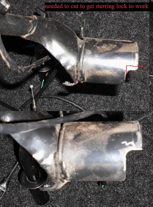

need to cut the sterring lock back so it will lock
sterring lockx.jpg (244.7 KiB) Viewed 8390 times

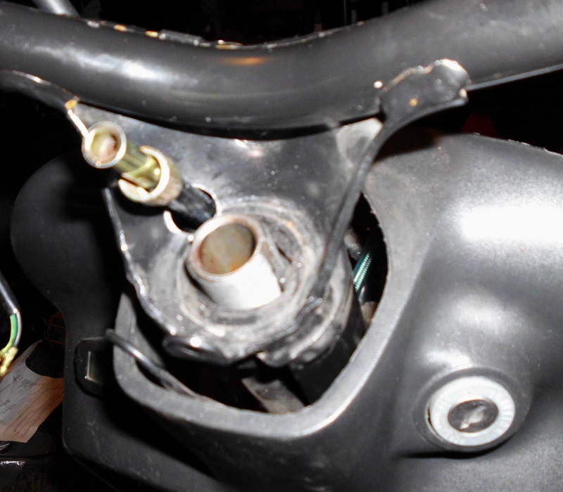

need a place for the speedo cable to go
my aluminum triple tree is pinned to the steel shaft
so the speedo cable wont go through the center
speedo cable.JPG (186.89 KiB) Viewed 8390 times

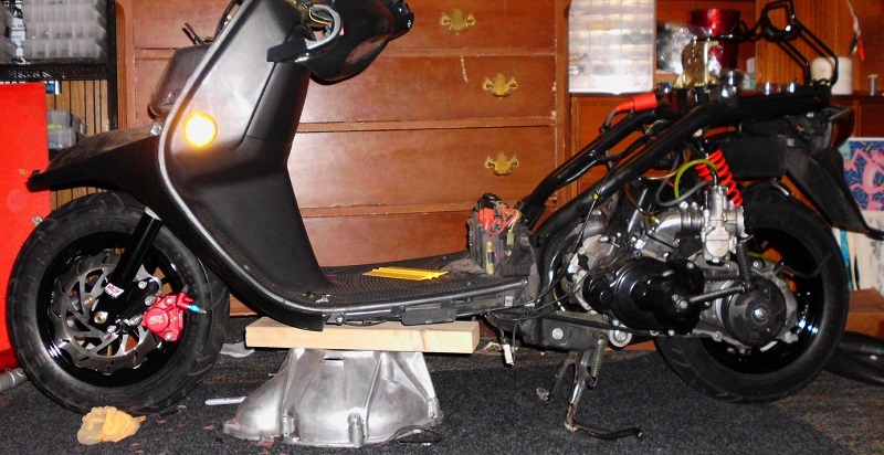

Posted: Sat Feb 21, 2015 1:36 pm
by cruzingratiot

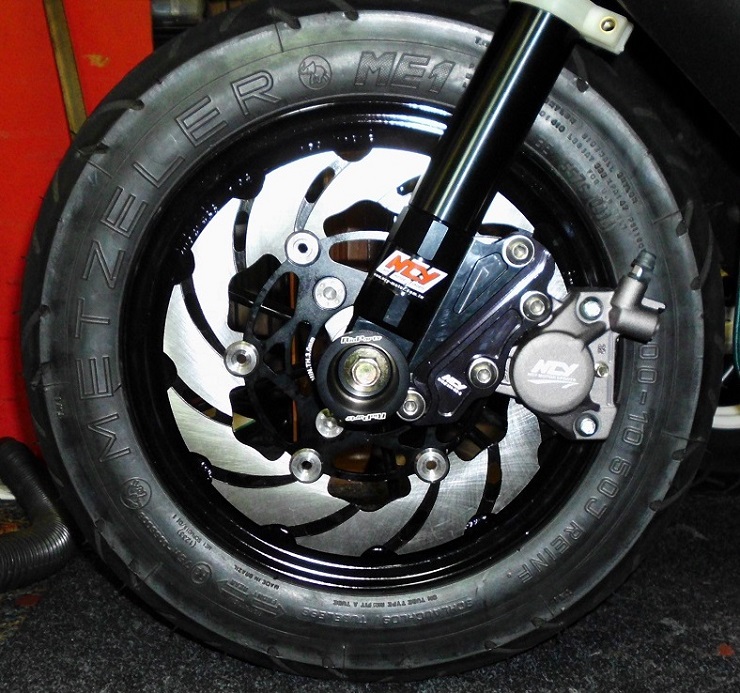

got my 220mm full floating rotor in today
im thinking the caliper should be black
just waiting on some panel bond to repair the glovebox and the inner fender
than hopefully final assembly soon

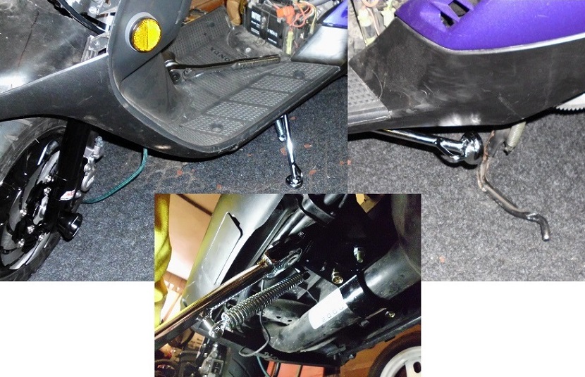

and my kickstand arrived

Any reason for switching the caliper/rotor? Just color? Any fitment issues with the NCY gear? I assume you have a NCY rear rim also?? Any fitment offsetting for that? OR was it a direct fit?
Looks great! Subscribed!!
Posted: Sat Feb 21, 2015 8:48 pm
by cruzingratiot
TinyElvis wrote:Any reason for switching the caliper/rotor? Just color? Any fitment issues with the NCY gear? I assume you have a NCY rear rim also?? Any fitment offsetting for that? OR was it a direct fit?
Hopefully I answer this below if not please ask again
nothing wrong with the rotor or caliper
I just wanted a full floating with black center
and the caliper I wanted a black one which Is gun metal in the pic ill take care of that soon
also going with black brake line and banjo bolts
not looking for anything flashy want a clean stealthy look
matching rims yes
jiangwayne.com has front and matching rear
front
http://www.ebay.com/itm/IN-STOCK-ZOOMER ... 2a403ad8f1
rear
http://www.ebay.com/itm/IN-STOCK-ZOOMER ... 27e77b388c
rear bolts right on no modifying at all stock tire sizes front rear

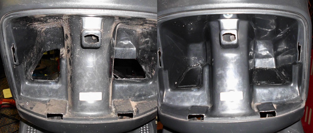

Posted: Sun Mar 01, 2015 6:47 am
by cruzingratiot
finally starting to put back together
first the glove box
figured it would be easer to fix if I cut it straight agross
cut a piece of abs and some 3M pannelbond pn 08115
I have a glove box again
now on to the inner fender this will be the not so fun part
