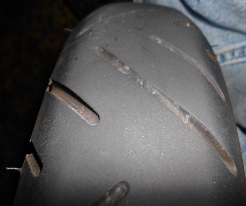

1450 miles on odometer is when I originally put the metzeler me1 tires on front & back
than at 4460 miles on odometer Jul 16, 2014 than I put a new front tire on
and put the front on the back so the original front tire had 3010 on it when I made it a rear
today 6785 miles on bike 2325 miles on front tire turned into rear (5335 total miles front and rear time)
decided to change rear tire could have ridden further didn't want to chance it
how far I used the first rear tire link
viewtopic.php?f=20&t=27850&start=150#p256940

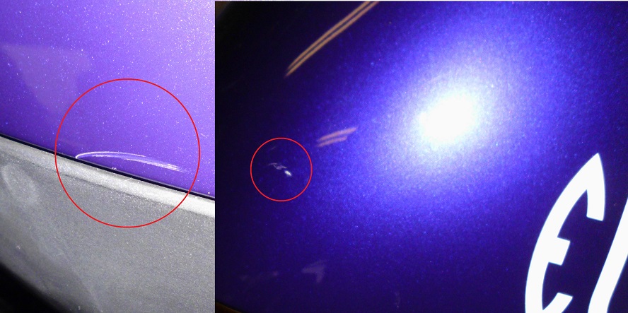

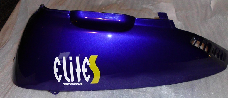

after getting 2 bent panels from Honda in march
gave up for a bit trying to find a good rh side
mine has a couple of small scratches most people wouldn't notice
got lucky on ebay and got one from a local Honda shop cheeper than I can buy it for online
now if I can only find a nos hood mine has a couple small scratches from my oops in march
and the hood is the only purple panel that hasn't been replaced
83450-GS7-850ZB CVR, R. BODY (TYPE2)
viewtopic.php?f=20&t=27850&start=240#p267836
new
scratches
