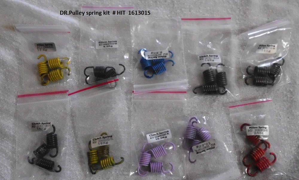

Dr pulley clutch
information on dr pulley clutch in link below
Link->
http://www.unionmaterial.com/Hitclutch-19.htm
now to go install and tune it in
what comes in the box
extra spring kit
Last edited by cruzingratiot on Tue Sep 15, 2015 11:19 pm, edited 2 times in total.

cruzingratiot
Posts: 328
Post by cruzingratiot »
lost some take off ( will solve that with stiffer springs)
but from about 5MPH up pulls a lot better
and the riding rpm's are lower because the clutch isn't slipping
and the clutch bell isn't as hot after a ride
worth buying in my opinion
