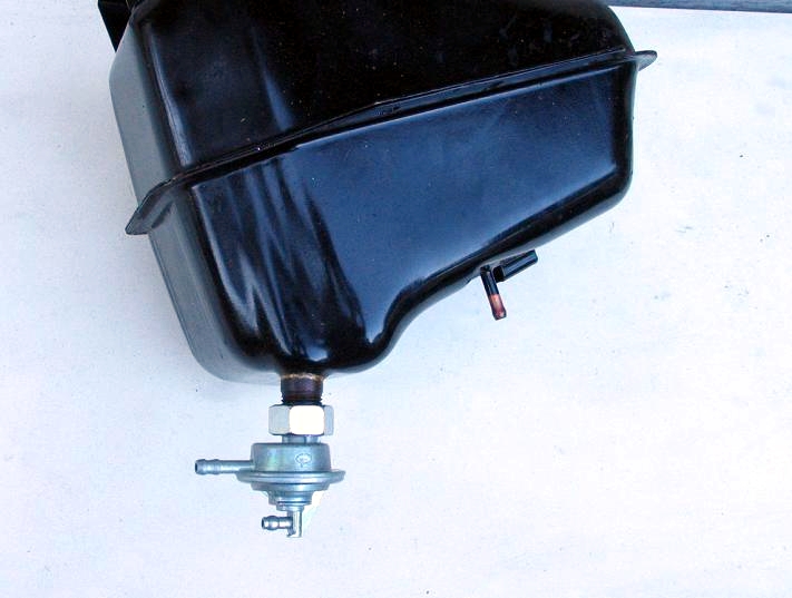

Mocked up a potential vacuum petcock mod for the NN50 and TG50. We'd need to put a tap in the intake to supply vacuum, but parts are easily available Hobby shop screw in taps for vacuum or oil
The attachment NN50_Tank_Spree_Petcock.JPG is no longer available
I hope your going to post some pics of the LED turn signals ,I also used the electronic flasher because of the low LED voltage . Yes the petcock stuff can be a hassle .I ordered the china one but still haven't tested it yet but at least it's an option .

66Six - Yeah - that petcock you and taz found looks good. I'll create a page for the petcock finds. Vacuum petcock mod I'm working on is just another alternative. The LED flasher you are using is very much like the one I found a year or two back - same brand too. I'll post some details soon. Right now my pickup is up on blocks getting all the attention:lol:
