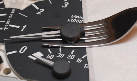

I swapped gauges in an old Mustang I had years ago. It required removing the needles and it was easy. You can buy a needle removal tool but all the Stang Forum guys just said to use a fork so I did. It worked like a charm but the hard part was putting them back on in the perfect spot. Speedometer was easy to reinstall because it was at 0 but my gas gauge was always a little off after that..lol

Meatball wrote:I swapped gauges in an old Mustang I had years ago. It required removing the needles and it was easy. You can buy a needle removal tool but all the Stang Forum guys just said to use a fork so I did. It worked like a charm but the hard part was putting them back on in the perfect spot. Speedometer was easy to reinstall because it was at 0 but my gas gauge was always a little off after that..lol
I bet it wouldn't cost too much to have these printed on translucent plastic sheets so they can glow when backlit. Of course if the time and money is put into this effort, it should be done in a large quantity to distribute to others. The "High Beam" and Oil Light holes should be added and maybe fine tune the "empty" side of the fuel gauge as well. Also add a KPH line under the MPH like most vehicles have for our neighbors to the North.
Anyone have a connection to have these printed up?
Thanks for the fork trick, I'll have to remember that one.
