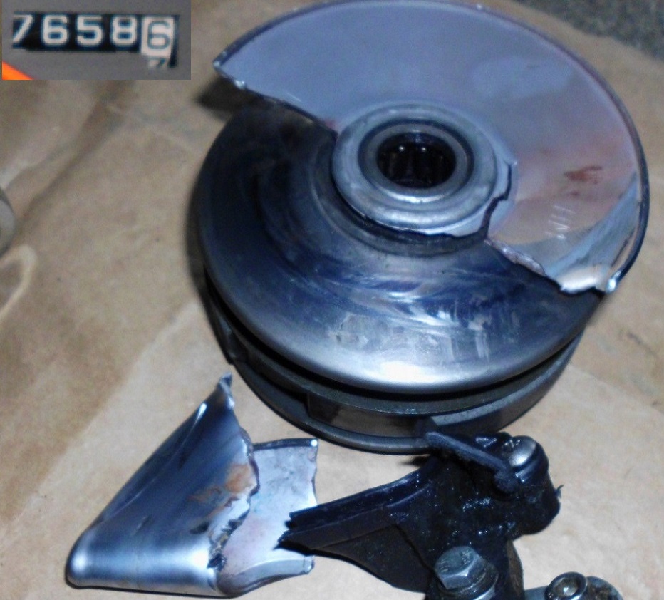

just a heads up
I would check your rear drive face for cracks ?
at least I wasn't far from home
doing 35 40 mph ish
locked the rear wheel up for a split second
repaced rear drive face assembly, belt
and repair crack off piece from airbox
1470 miles on odometer when I rebuilt motor
7658 miles on odometer
6188 miles on build
rear drive face.jpg (240.12 KiB) Viewed 16459 times

Oh d***, yeah I checked mine for cracks, ill check it again in 200 miles after break in. But yeah nah not gonna wanna see that. That aint looking fun yo.

Holy crap! Ive never seen that happen! Was that on the Purple bike?

yea happened this morning was cleaning and making sure everything was ok for the ride

This has been reported on the Forum. Apparently the stronger Contra springs put too much tension across the pulley at full-shift.
I never saw this discussion but just as a reminder to those who have not

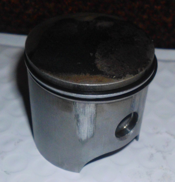

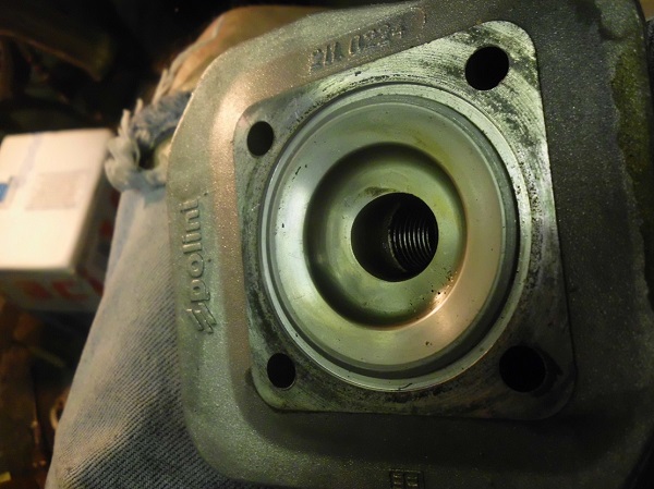

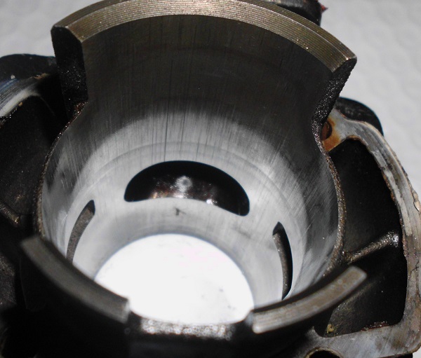

8080 miles
148-150 psi compression
klotz R50 32-1 since day1
7000 miles +- roughly on bore
decided to put new bore on it
honed and sold old bore with new rings
166.0079 chrome top ring
206.0200 cast bottom ring
209.0383 gasket kit
fyi 204.690 is replacement corsa piston kit stock bore
no marks could be felt with finger nail
