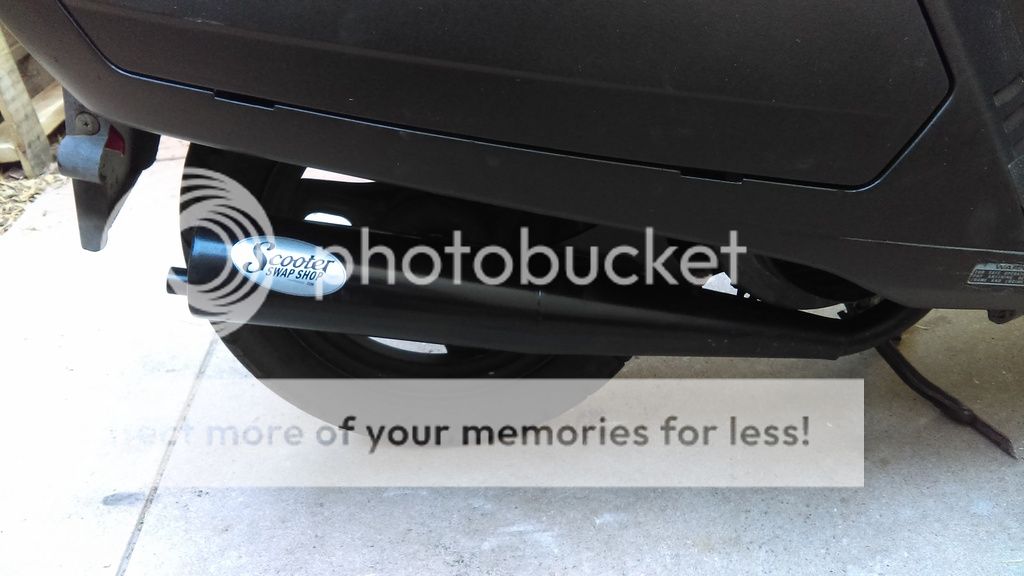

kjkenney
Posts: 43
Joined: Tue Jun 02, 2015 7:48 pm
Location: Tempe, AZ
Re: AF05E Exhaust List - Aero and Elite 87-93 engines
Post by kjkenney »
Went that route and got the SSS pipe second hand. Holy crap it's a beaut! Sounds amazing and fits perfectly.
