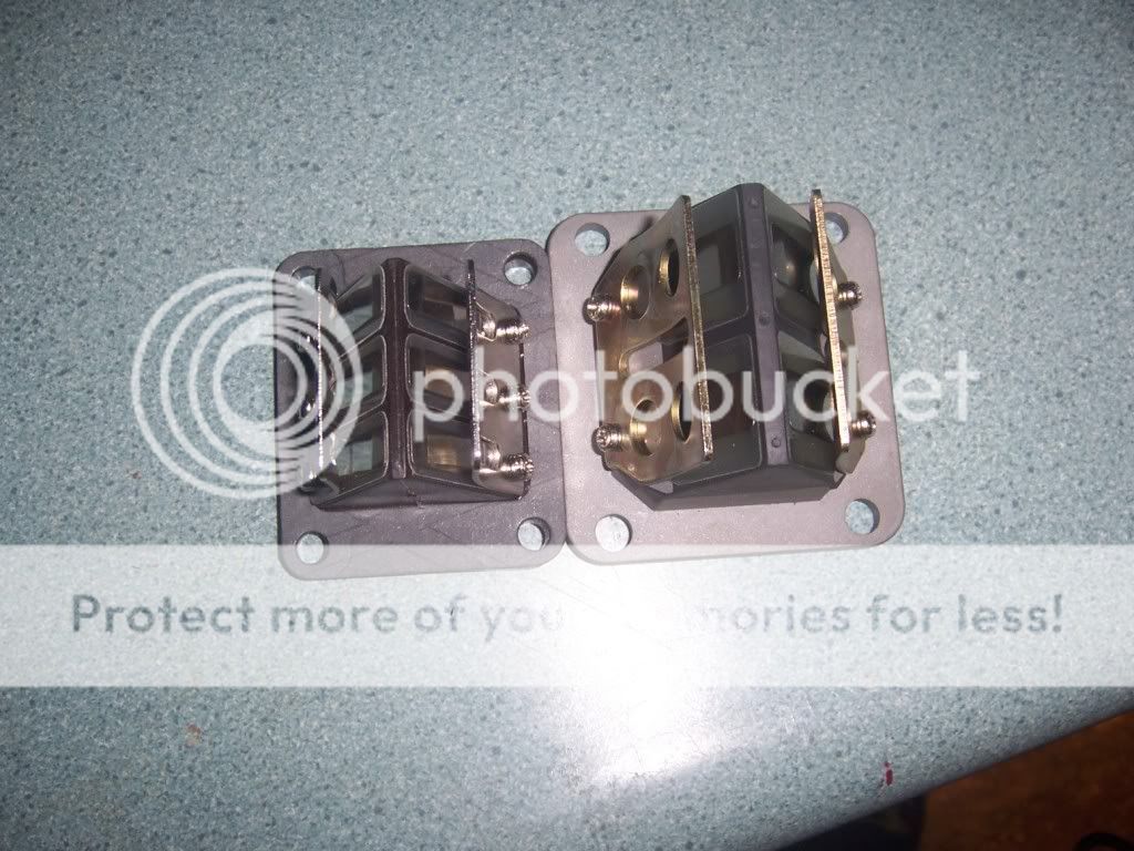

Bear45-70 wrote:Reed comparison for my Black and one of my regular CT.
The Black has a single monster petal on each side of the "V" while the regular CT has 2 petals on each side with a divider in the middle of the reed block.
6 pedal reeds that came with a ct chrome vs BIG CT black reeds.

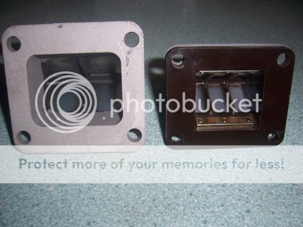

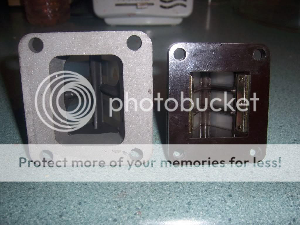

Re: MONSTER Spree
Here are a few different comparison shots
Re: MONSTER Spree
The reed stops are also restricting the air flow. My Black has NO reed stops, so the walls of the manifold are what restrict how far the reeds can open, which can allow a higher maximum air flow which raises max RPM = speed.
Re: MONSTER Spree
Bear45-70 wrote:The reed stops are also restricting the air flow. My Black has NO reed stops, so the walls of the manifold are what restrict how far the reeds can open, which can allow a higher maximum air flow which raises max RPM = speed.
These reeds fit the BIG black intake............no restricting reed stops here. :smile:

I also have a Big ct... there is not much to compare between the std CT and the Big CT... as the pic shows it has WAY more reed area.
Bear why do you have to always argue even when its obvious your wrong?
Re: MONSTER Spree
ottoman wrote:I also have a Big ct... there is not much to compare between the std CT and the Big CT... as the pic shows it has WAY more reed area.
Why do you fear another view? Oh and I am not wrong. My Black has a totally different reed set up than any of my regular CTs, 4 or 6 reed. and in my opinion it is better than the one that Tjamz has.
