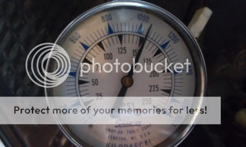

I did the compression test today. 155psi :surprise: That's really high for a street setup.
