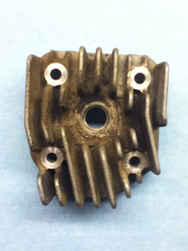

4
- ImageUploadedByTapatalk1332035336.676650.jpg (138.19 KiB) Viewed 6037 times

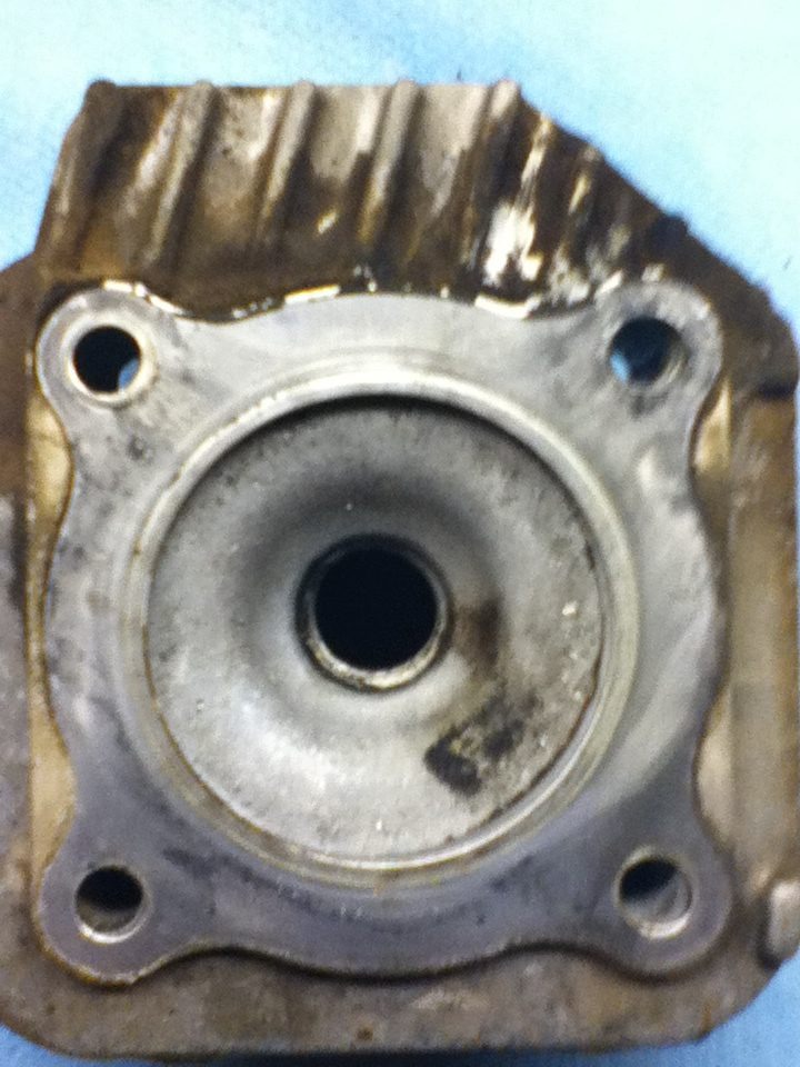

My 85' spree wont run????
7 spark plug plate has some metal burrs on it...
- ImageUploadedByTapatalk1332035448.709907.jpg (149.26 KiB) Viewed 6035 times

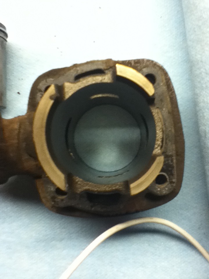

Let me know what u guys think I should do the cylinder looks good I don't see any major ware marks or scratches at all thanks guys!

Re: My 85' spree wont run????
i did just noticed this on the cylinder i dont know if its how its suppose to be but i think its worth metioning.
