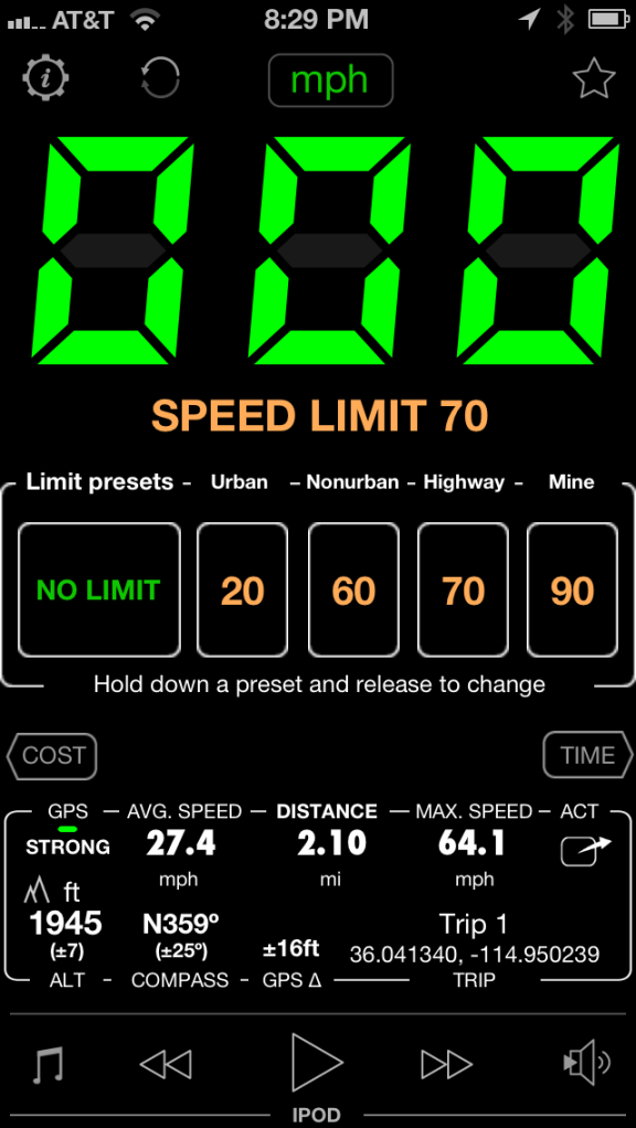

Pay no attn to this...
Got another 1.5 out of it
