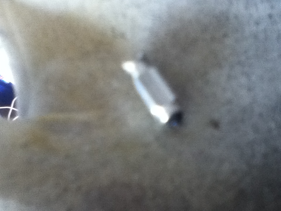

Succcccccccccccccccceeeeeeeeeeeeeeeeeessssssssssssssss!!!!!!!!
Thanks all who support me with my moped . I finally found why gas was not able to get to the engine. I don't know what you call that tube . But check the picture . I had tons of dirt that stack in that small valve . Man I couldn't believe what I saw . Once I get it out . Put the valve back to get my problem is all gone. It is running all fine .
Yep that was my problem Got half of that small tube filled with dirts
Re: Need a quick help For my friends Honda Elite .

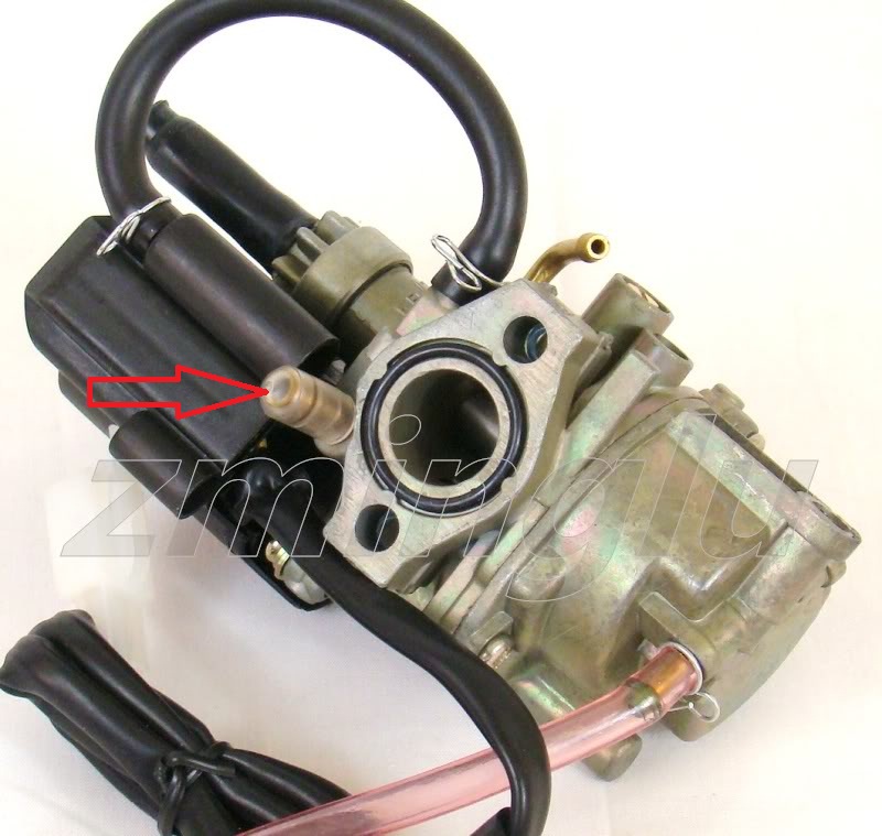

Glad you have that fixed. Its the fuel inlet. The fuel inlet has the largest dia line. Vac and oil injection get smaller id tubes :D

I had cleaned it like 6 times and I also used the card cleaner. There is no way that the carb clean will of clean what came out from the fuel intlet. Its was like a small pieces of rusted metal and dirt over it. SO what I did is I take the tube on the carb clean and used it to spray in every hole and try to look carefully where the the fuel will come out . The first time I clean the carb with the carb cleaner I just spray it on there and let it sit . I guest I didn't do a good job the first time. :peace:
Posts: 4815
You know this rust and dirt is coming from the gas tank....Install a fuel filter to avoid repeated trouble. Use of clear fuel line is helpfull. Tank cleaning is in order.
spray -can carb cleaner is not as strong as carb cleaner that comes in a gallon can...Berrymans brand is $20 a gallon and will clean hundreds of carbs. Compressed air is a essential part of carb-cleaning. The teeny-weeny passages that have clogged from years of sitting with gasoline in them will become impossible to clear with spray-can cleaner alone. Sounds like you are finding some of this out the hard way, but you are making progress... :2thumbs:
