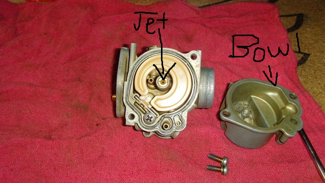

Alright man im going to try and be nice..... the bowl is the name of the part of the carb that u take the screw off and attaches to the carb the only movable part in the bowl is the drain!!
carb bowl jet.jpg (116.86 KiB) Viewed 8510 times
the jet it the thing with the tiny hole and needs to be soaked in carb clean and blasted with compressed air. i take apart the whole carb and soak it in carb clean by the gallon.

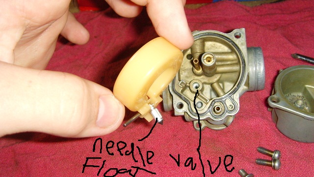

valve neadle float.jpg (100.29 KiB) Viewed 8510 times
the needle valve is where the gas comes in and is always where my problme is soack the whole carb assembly in carb clean and blast it out with compreesed air. also make sure the float needle isnt scratched.

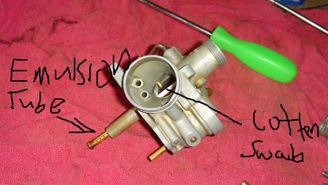

next use a cotton swab to push out the emulsion tube AFTER you take out the JET (only jet...) soack all these parts in carb clean and blow with compressed air
(dont soak rubber pieces in carb clean)

as well as the other pictures have indicated, you HAVE to clean the pilot jet. it gets clogged very easily, and can be quite a pain to clean if fully clogged. best way to clean is with an 11 gauge guitar string or similarly sized piece of stiff wire, spray in cleaner and let soak, poke around in both sides of the jet, blow out with compressed air and repeat untill you can get a pin * of light through it or a steady stream of air or carb cleaner to flow through it.

Wow, thanks for the pics and descriptions. Now i can tell you that i've taken out the main jet, but never the emulsion tube. I've also never fully taken off the idle speed screw or Air mix screw. Are those things that i need to take of and cleaned for sure? Im like 90% sure that my issue is the pilot jets clogged, but cant figure out how to get down in there to clean the small hole. I ordered a carb cleaning kit off ebay (not here yet), but i'll try to find that guitar wire this weekend instead. What about that small hole in the bowl? Throw a pic of that up as well, just for those who follow this thread years from now, lol.
