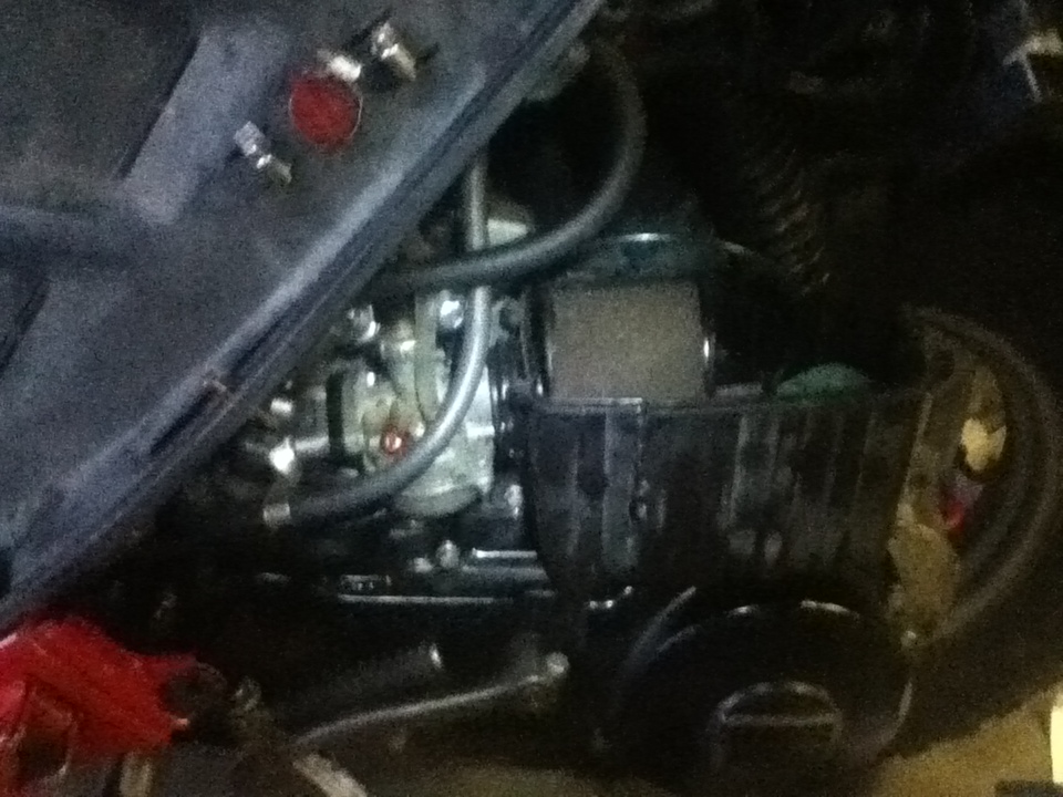

o.k. -- I'm going to attempt what has been suggested with the hoses from control box to carb&manifold. For tonight, I'll basically cut hose 1 and 2, and cap off & label all 4 resulting loose ends. then I'll try running the scooter up to operating temp. Tomorrow I'll go get a nice ball valve with barbed ends. Considering the intended use (gasoline) do I need anything special? Thanks much.
Re: New member section?
Mostly air but a plastic valve would be a bad idea.
Seems like you should slow down a little and take the advice of taking it back to stock. That device (whatever it is) doesn't seem to have anything to do with the bystarter - it looks to somehow be supplementing or replacing the main fuel line. On the bottom of your tank is an automatic fuel valve (petcock) - it has 2 lines coming from it - the bigger one supplys fuel to the carb, the smaller is attached to the manifold. Vacuum from the manifold opens the petcock and allows fuel to flow into the carb. Make sure that system is working properly - it may be that rather than buy a new petcock, the PO has rigged something up when it stopped working. The petcock can be checked simply enough - remove the vacuum line and fuel line from the manifold and carb - the fuel line should not allow fuel to flow unless there is vacuum - suck on the vacuum line and fuel shold flow.
Look at Bear's picture - you have all those extra lines attached and your fuel hose is attached to that device somehow - is there any way to contact the PO and find out what he/she was trying to accomplish? You may also want to find out if he/she did any other mods - an after market air filter like that may indicate bigger jetting, if not, then it will be running lean.
Is it possible they were trying to add more fuel to the system thru that device - who knows?
You need to do more figgerin and less experimentin - have you downloaded the service manual?

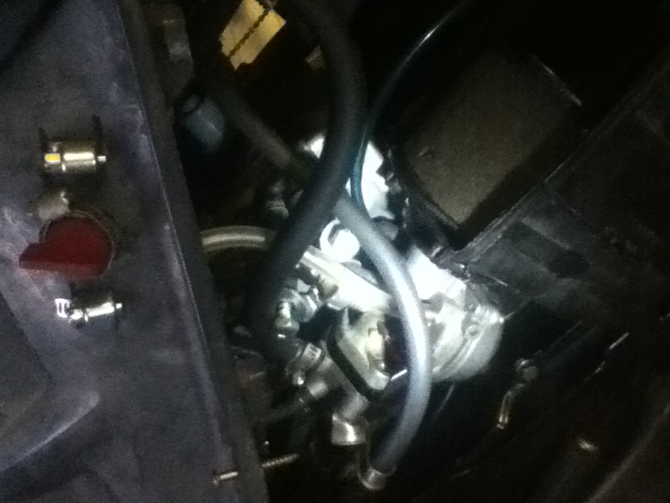

well, the valve is in. cold start is easy as pie. still stumbles
off the line but a fair bit less. my test run was over to carl's cycles... he spent a half hour looking around and charged me $20.70 for a handful of gaskets which he put in for me. He said it is pitted badly throughout and not long for this world and to never run ethanol blend again. Oops.
a new stock carb $35. The setup I want, around $70.
at least it idles now and is safe to run on the roads. I await payday, the 15th when I can get the carb and intake I want.

Bear wrote: In my opinion the reason the scooter is a dog off the line is the the bystarter is making it run very rich and once you get about 4000 RPM the engine will handle the extra fuel. Mine does if I forget to the the valve.
yes, it seems so. however, my carb/intake seems to be ailing, so my original plan seems more prudent than ever, in spite of NAYSAYERS who likely sit in the dark to avoid possibly damaging the light socket by putting in a new bulb.
pics of the day's efforts:

motormike wrote:This portion of your post has me wondering what is your logic ? The bystarter, if found to be functioning properly, you will trash regardless ?...hey it's your scooter. The electric choke on my truck works fine, but I'm not going to disable it and try to replace it with something else, regardless.....zadman2012 wrote: I most likely have some vaccuum leaks to track down and may find the bystarter works, as I suspect already, just fine. It will be disabled regardless.
not trashing it, just pulling the 2 hoses suggested. Disabled, as in, not using it. I can tell an alpha personality when I see it. Let's just agree to disagree. I don't want it, and will not use it. "nuff said.
The '83 and '84 Aero 80 came with an 88 main jet, which was EPA lean. A 90 main jet cures this. You can replace the stock reeds with some Boyesen dual stage reeds #740. They will improve the off the line performance and help the top end a bit or you can go with the CT intake and a 21 or 24 carb. You will be running a pod filter on this set up, so the air box becomes mute.
