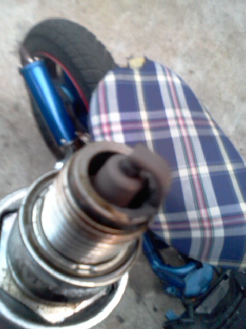

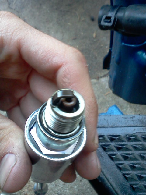

Took a few videos and pics here they are.
It's still a little lean up top, but it does this wierd bog thing when it idles for about 45 seconds or when I first start it and it runs REALLY rich, but it seems to idle perfect if I just let it idle I get a great chop?
1.5mm jet ~ 112.5 mikuni and fuel clip at the top of the needle

bakaracer
Posts: 3519
Location: tacoma,wa
Re: bbk and pipe need some carb help!!
Post by bakaracer »
2Stroke plug read is at the base of the porcelain. Its more a wot plug chop is what you want to do. That way you can get the main jet dialed in. If the needle clip is at the top of the needle, somewhere is way to rich. Either pilot jet to big or air fuel screw is screwed in to far. Base starting point for your carb should be at 1 3/4 turns out ig its runs better more than 1/2 turn closed , up the pilot.if it's more than 1/2 open from starting point , pilot to big. Needle setting should be in the middle. If your in between pilot jets and carb is not crisp , then adjust the needle

7m-iata
Posts: 72
Joined: Sat Jul 02, 2011 11:28 pm
Location: florida
Post by 7m-iata »
yeah I'm gonna drop a pilot size and go up 1-2 main sizes tomorrow seems like it should work out pretty good. Will it being lean up top cause my high idle for about 30 seconds until the cumbustion chamber cools from idling rich? Thats where I'm a little confused since it idles high (lean) after a wot run for 30-45 seconds before returning to regular idle I'm getting close on my main being the same size as the tube running into the carb itself gonna check AGAIN for some sort of air leak tomorrow as well /: The base of the ceramic seems the same color as the tip of the plug every time I check it I took the pics trying to show the base but my cell doesnt want to focus on the plug very easily more of whatever is behind it lol

YAYYYYY!!! finally found my intermittent leak it was the variator side crank seal, I replaced it tested for leaks then reassembled. Started re-jetting it runs WAAAYYYYYY smoother and returns to idle every time I stop with no problems. I'm still have the same issue up top though, I've jetted up to the point that my plug comes out pretty much black it pulls fine through most of the rpm at the jetting I'm at and I get a decent chop, but up top it still has a real loud "clack" noise coming from the carb, doesnt sound like spark knock and I'm running premium 93 oct with 155psi compression so it shouldn't be knocking. I'v jetted and whether its lean or rich it makes the same noise at the same speed every time, I've pulled the cyl apart and no contact anywhere, replaced the reeds and made no diference. /: any ideas? I would record it, but it would just sound like a bunch of noise unable to hear the clacking above the rest of the noise...
Edit tried recording it, this is what I could get. the high pitched noise is what I'm hearing except its not a constant noise. http://youtu.be/yT0N-cG_Ef0 and added the pic of my plug after that ride
