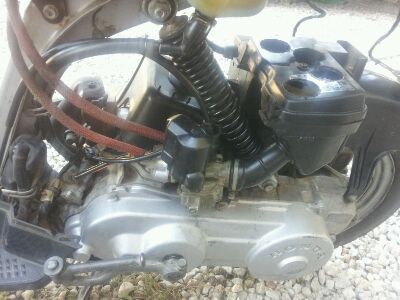

She's alive with taz's kit! Break in time. Good postings fellas. Appreciate your input. Will post once I can open her up. Later.

Gree-aaaauuuGGGHHH!
Too clean! TOOOO CLEANNN!!
What compression did you get when you cinched it down?
Have you decided on a pipe?
Whazup with all the giant holes in the airbox? That looks like a stock carb, is it? If so be careful coasting downhill. There is a danger of overheating due to tiny Pilot, particularly if you've defeated the Honda-ordained negative pressue on the intake side upstream of the venturi. Brake with the throttle open to prevent cooking the top end, or just adapt an Arreche 17.5.

agree when we say holes we mean 1/4". You might as well run without the lid with those holes.graphite9 wrote:Your gonna seize that motor with those holes in the airbox.

Just following directions. I.did cover one up. Also the directions call for 3 to 4. 1" holes or a uni filter.
Psh. Will see ladies. Time will tell, If your right kudos to you. And I will give her away.

I would strongly recommend a temp gauge for that thing. It won't show the fast spikes that could seize a cylinder but you'll have a really good idea of what's happening temp wise. Heat cycle the living daylights out of that cylinder before you drive it any. The temp gauge is very useful when heat cycling because you can truly know the cylinder is cold and when its up to temp without wasting time

New tires. New brake cables. New mirrors. New.seat.cover. Taz.big bor.kit. It sounds.meaner than it is. Barely climbs.hills still. I'm done fixin her up. She's a spree.what more.can I sayinkerb2b wrote:Updates?

Still a blast to ride! I need to get her on some flats and.really.see what happens. This.was.my.first.piston replace so I learned alot. Viva spree.heads!
