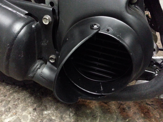

Hi forum.
I did some adjustments on the carb and added a scoop.
It did bring the temperature down a bit.
After a 10 mile ride @ WOT the max temp was 343 degrees.
I'm still working on the stock carb, may have to get a stock with the pilot jet. or make a bigger gas tank and put on 21mm or 24mm carb.
