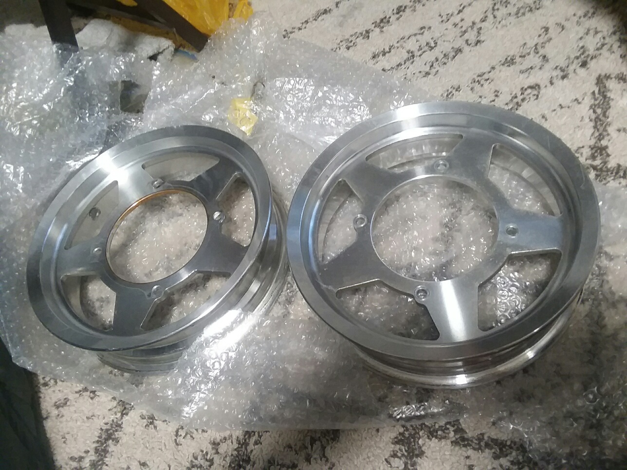

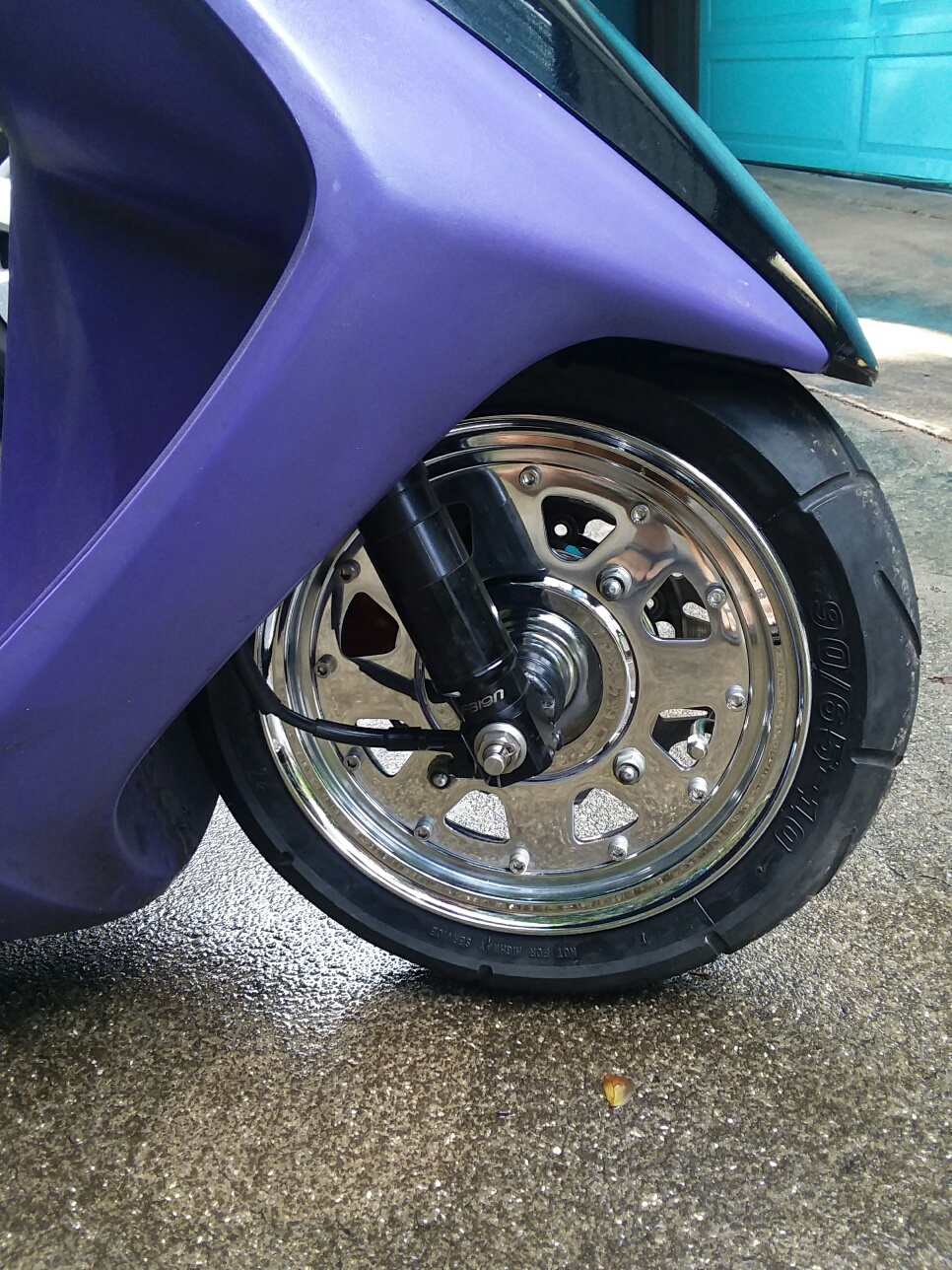

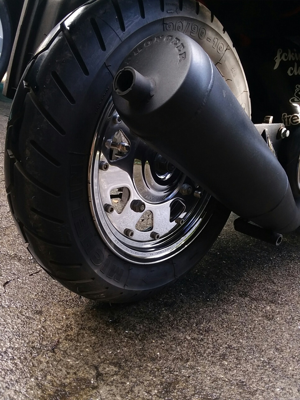

Thanks guys. I got the wheels on, still looking for polished hubs to match. Also put the ZX yellow headlight back on, for now...

Thank you. Hopefully I can get the wheels back on in time for your visit. I need new bearings for the polished hubs I got :2thumbs:

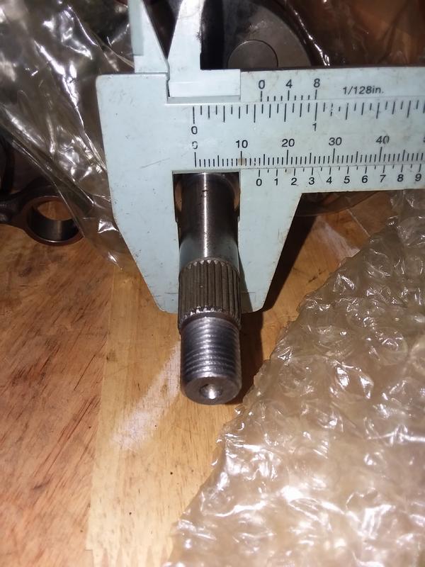

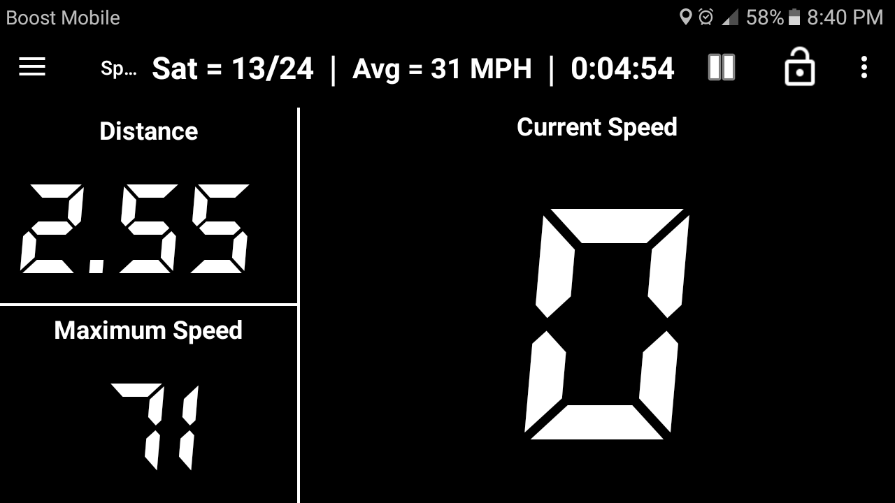

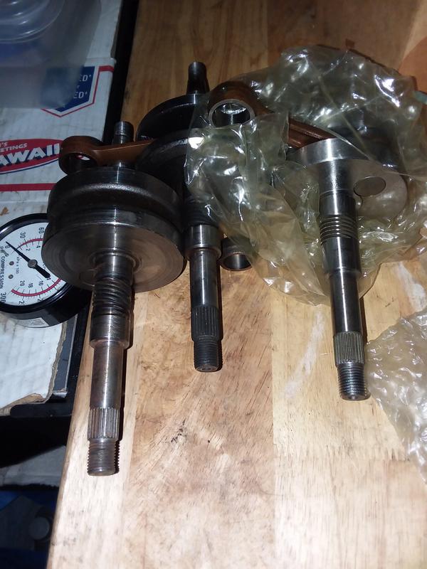

I finally put in the new MHR full circle crank and new corsa on my spare block. Noticed the driveface splines on the crank had some play with the driveface. Didnt think anything of it until I started up the bike. Burning belt smell and it whined like a super charger. $300 crank defective from factory I guess. Nvr buying malossi again.
Ended up removing the boat anchor and buying a PG stock stroke stuffed crank. Installed into the case after making sure the drive face splines matched up good. Topspeed didnt seem all that much better from my old corsa and stock crank.
I was wondering why my bike was toping out at only 60mph when it could do 65mph before the motor swap. When I went into the cvt to replace my rollers I noticed the rear pulley was harder then normal to compress. I took off the torque spring and found out ot was binding since all the grease was gone :oops: slapped in a spare rear pulley and the topend is back and some :rock: . Im liking the way this PG stuffed crank pulls. Although the malossi full metal one pulled harder.
GPS on flat ground tucked. Speed radar sign read 1mph higher :eyeroll:
Re: Project "Ube" Super Dio
Posted: Fri Oct 18, 2019 6:53 am
by sum_azn_kid

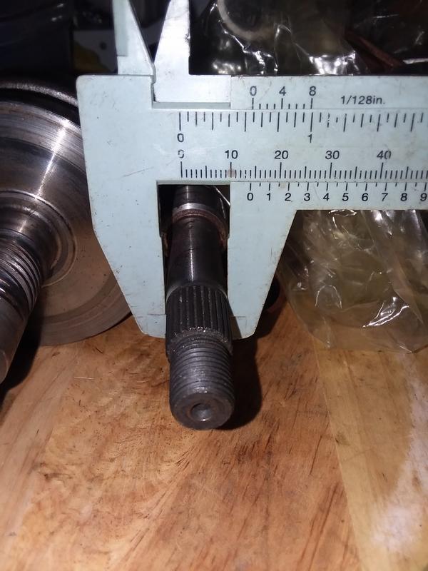

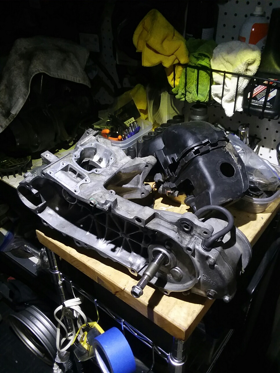

I tried 3 different drive faces. 2 sym/zx and 1 af16e all had play on the malossi splines. Heck even the ruima had a tighter fit :crazy: china crank better fit than Itialian....
Stock af16e, ruima and malossi cranks
And before people started saying it was a small spline crank :blah: I have a small spline af18e motor and the malossi crank is bigger... I learned my lesson always check new parts. I had this crank on my bench for about 1 year cant do anything with it now. Polini and PG FTW I would think for the price you pay for malossi stuff they would fit better. But Im not surpised their piston look like crap compared the the corsa's at least for Dio. I dont think Id use their parts for my jog project either. Dont want to risk or gamble my $ on it.

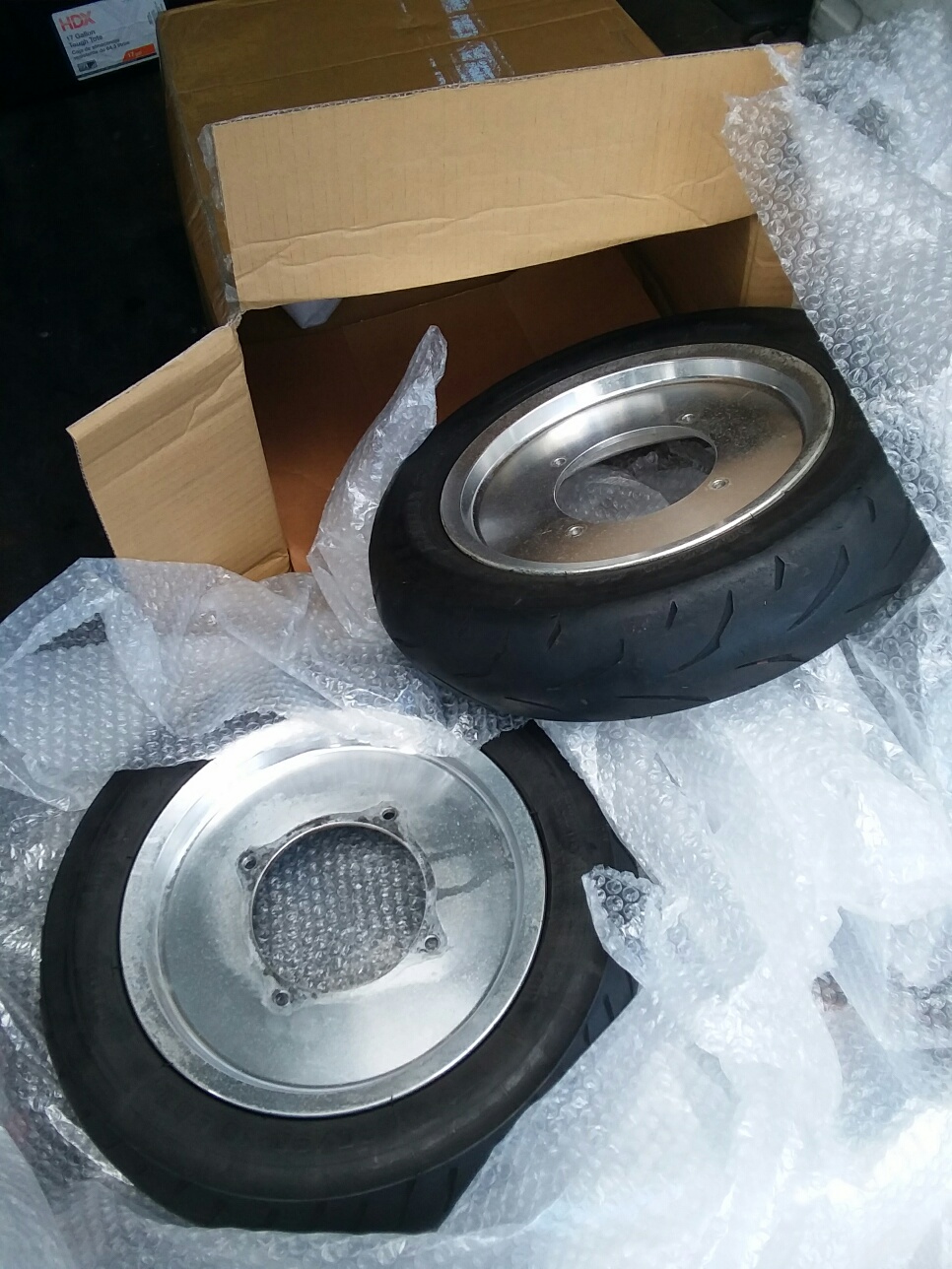

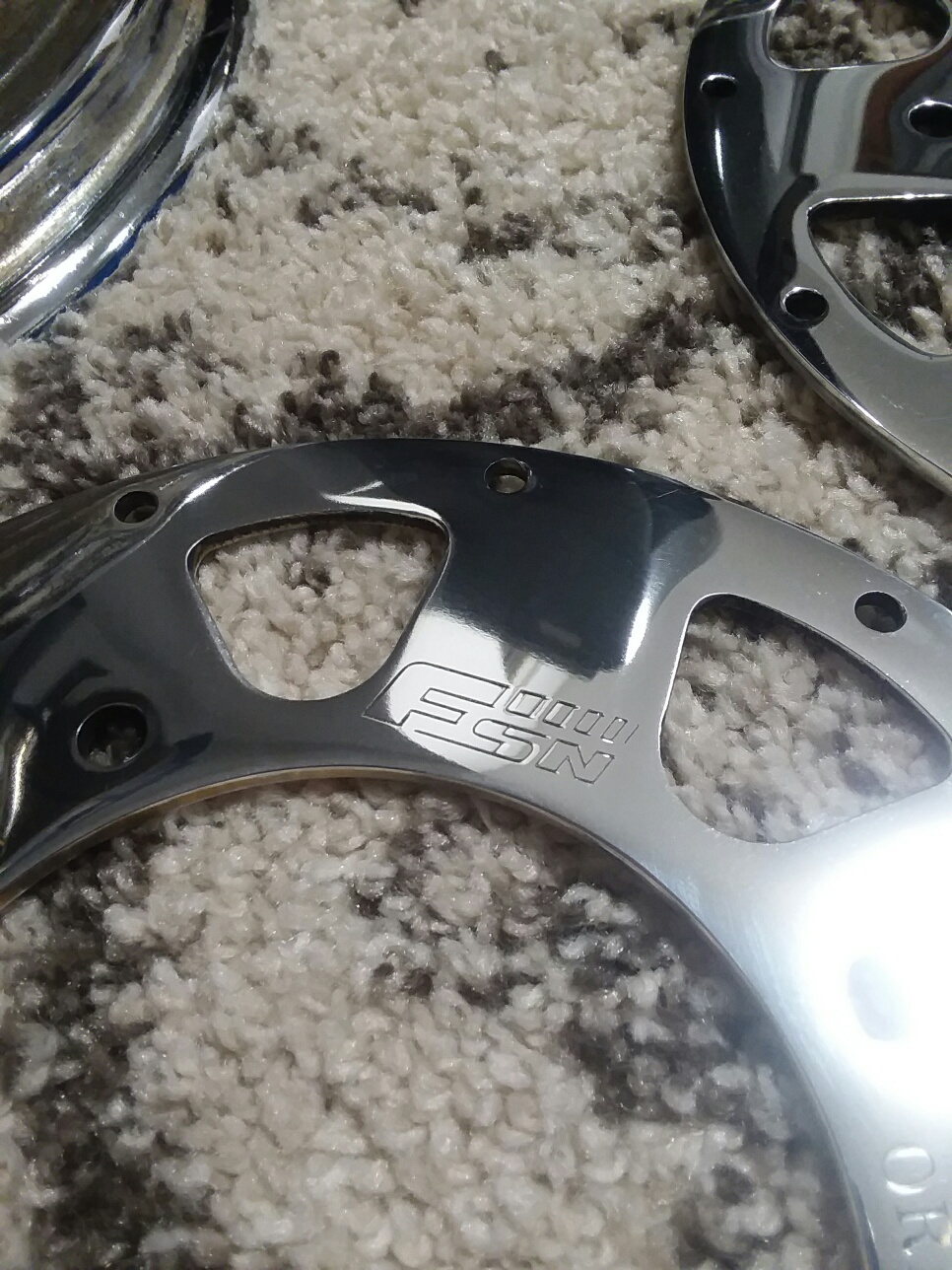

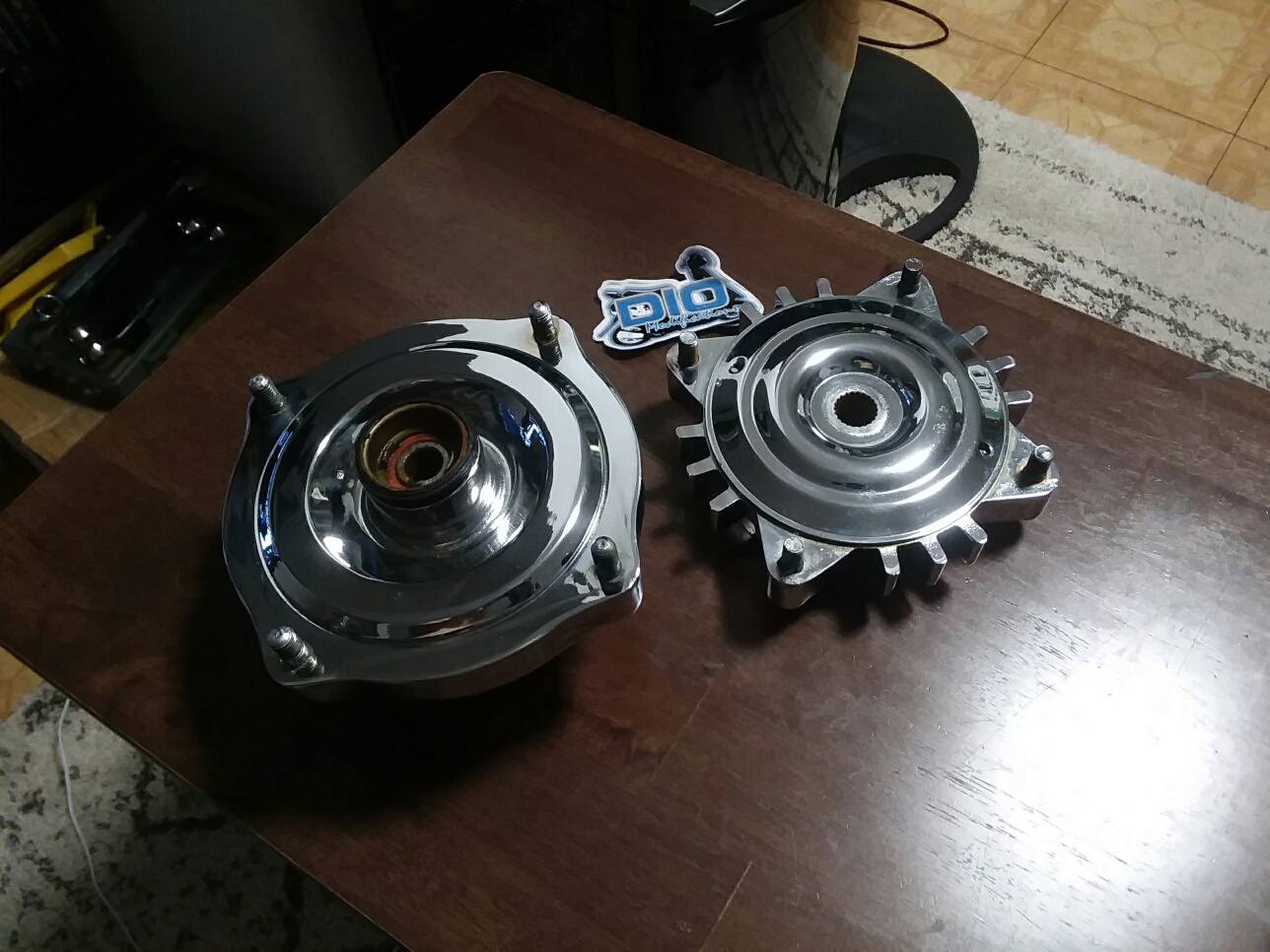

Picked up some spare wheels
Finally got some chrome hubs

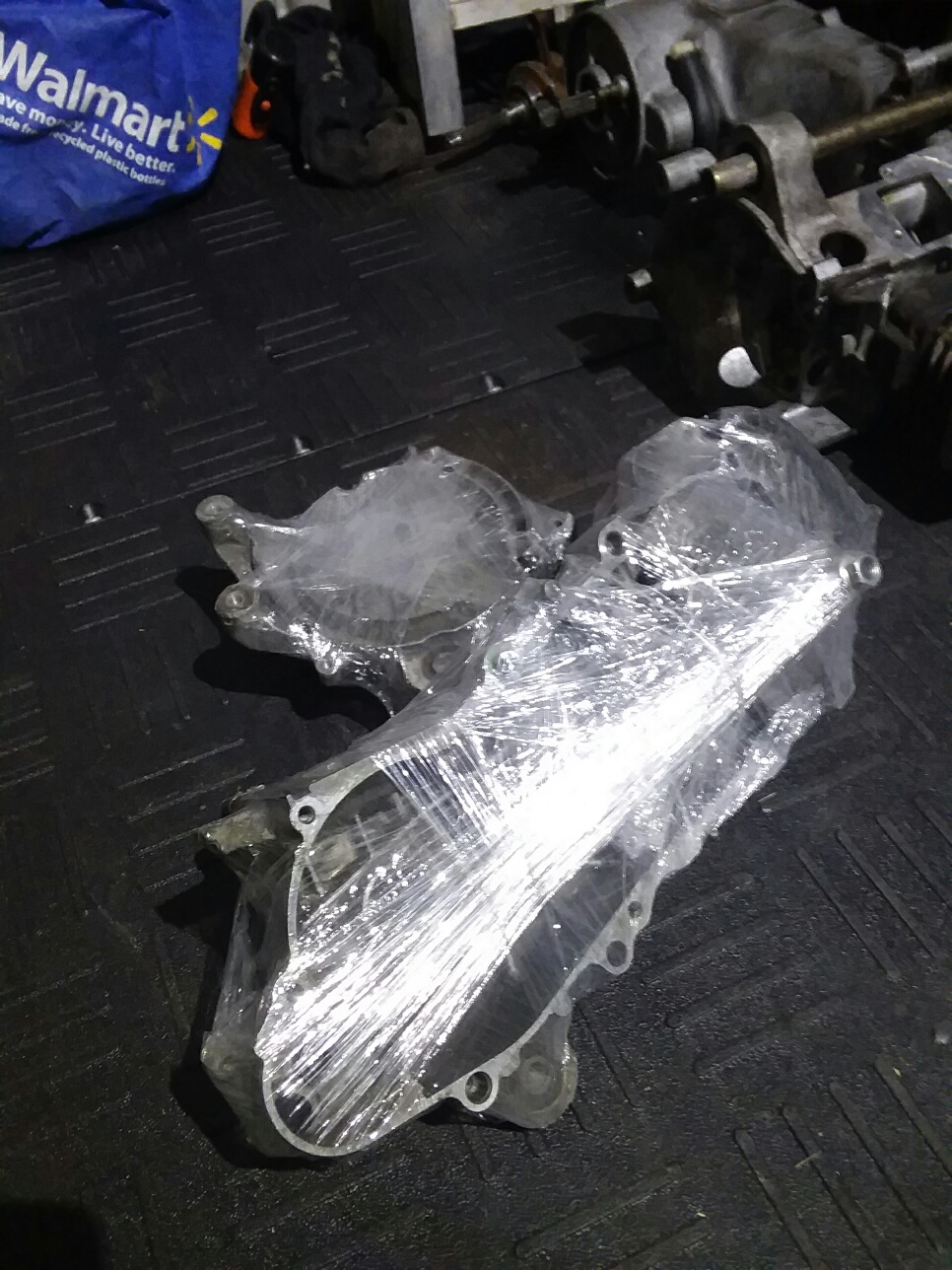

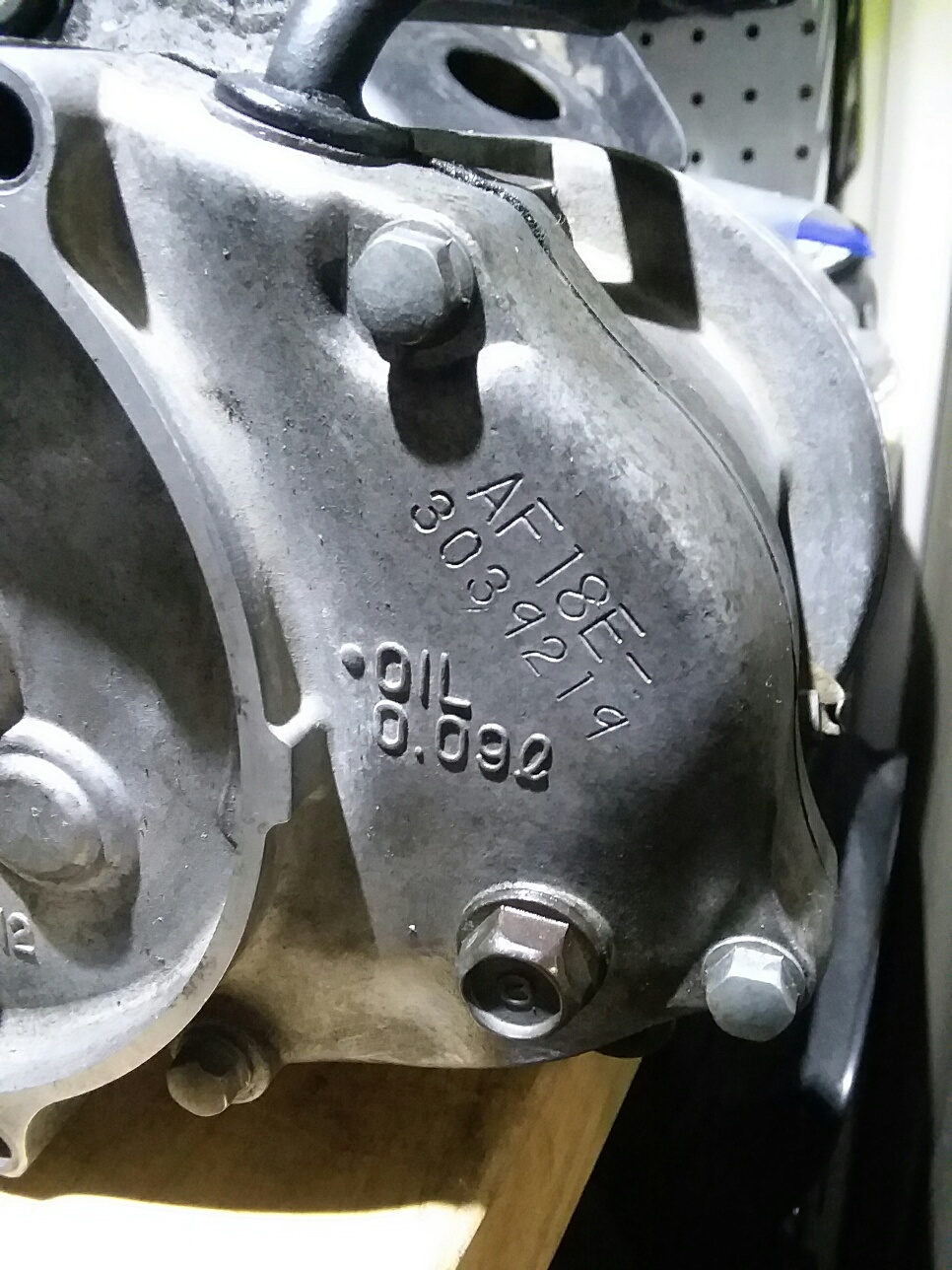

And brought an AF18e large crank motor back from my trip to Japan. Bought it for $20 :coolcruise:

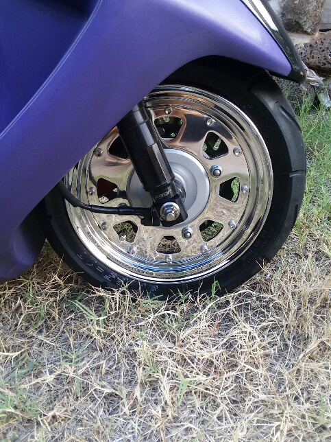

where did you get those solid wheels, and what is the hub bolt spacing???? ive been looking for a set of those in 2,10-2.75x 10 with a 141 pcd bolt pattern.. wanna sell those? my gyro and chopper spree will thank you.. lol :naughty:
Posted: Mon Jan 13, 2020 12:09 am
by sum_azn_kid
harleyracer59 wrote: Sun Jan 05, 2020 6:54 pm where did you get those solid wheels, and what is the hub bolt spacing???? ive been looking for a set of those in 2,10-2.75x 10 with a 141 pcd bolt pattern.. wanna sell those? my gyro and chopper spree will thank you.. lol :naughty:
Found in japan, I also made some friends there and they shipped it to me. Also there is a guy on Instagram from Philippines that can get them and chrome them. They are same PCD ad sym/kymco hubs I believe 4x140ish. And 2.50x10. TBH if it is for a gyro you maybe better off using atv wheels. Or having machined machines redrill a solid dwt wheel for you
