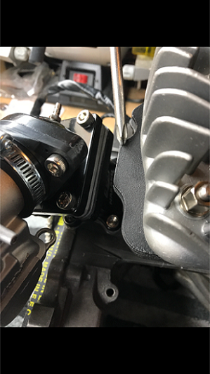

I had trouble fitting the plastic fan shrouds over the massive jug. Starting with the rear shroud, I had to shave a few plastic ridges off the inside to clear some fins....Then had to trim a bit of material off of the jug as well...my goal was to keep the plastic shrouds intact as much as possible to keep temps at bay. Pointer shows what fins need to be shaved. Pic shows mid process with burr bit. Only cutting to my reference line.

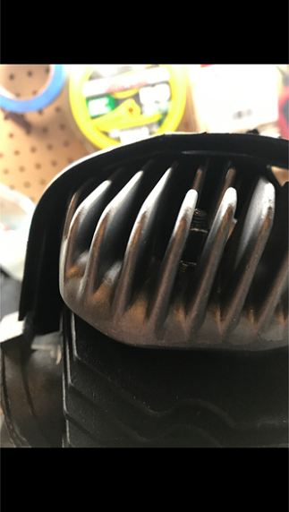

The front Fan Shroud was more of a challenge. There was just no way it was going to fit without massive trimming of the head fins...period.

After a few hours of careful grinding, filing and Dremel-ing..the shrouds fit like a glove. Im pretty confident the absolute minimum amount of materiel was removed to achieve the task. Removing 1/4" of the head fins isnt ideal since they are a vital part of the cooling process, however, big gaping holes in the top of the fan shroud would cause the forced air from the fan to exit the jug cavity prematurely. It would essentially starve the rear of the jug (carb side) of critical air flow. I picked my poison.

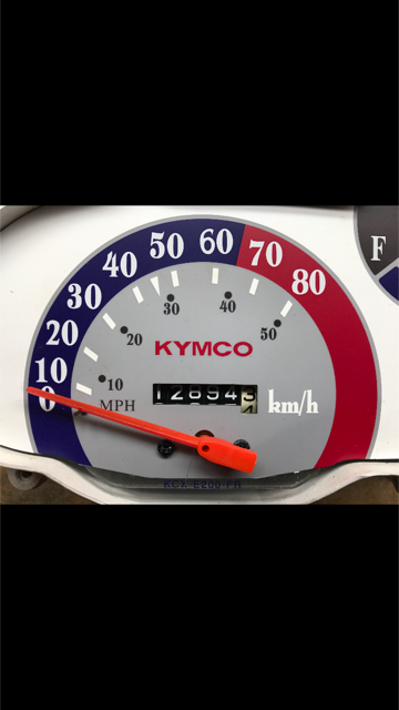

For tach/temp gauges I chose TrailTech TTO for both. Small, easy to install, cheap and they work well.
The 35mph speedometer will be useless so a Kymco unit will be installed. Its absolute plug-n-play for the SA50 head and it runs up to 50mph with room to reach 60-70 on the gauge. Im currently working with a local vinyl graphics outfit to design an overlay decal (sticker) that can cover the speedo numbers with ONLY the MPH and adding the 60 & 70 marks.

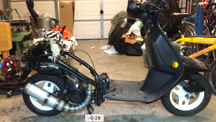

Motor is installed and running...the break-in process will be slow and methodical. I will remove the fan shrouds and visually inspect for leaks after each heat cycle and check compression after about 3-4 warm-ups. I plan on breaking this in very slowly with ample amounts of idle time while monitoring temps very closely. My area's Winter consists of 5-6 months of non-stop rain,wind and/or snow so riding is not happening any time soon. The stories you hear about Seattle rain are true.
