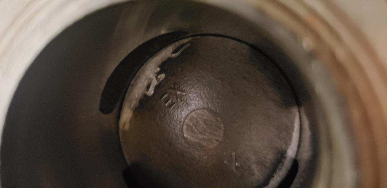

A few snapshots just to keep updated. I would like to start grinding on my 85 piston as i like the dished pistons a little better and i think its shape will aid what i hope to achieve.
Piston is always in the way of incoming flow and as the piston comes up it abruptly cuts off flow. A 45-50 degree slant at the crown would open the port sooner and taper of the flow of air/fuel rather than just cut it off.
