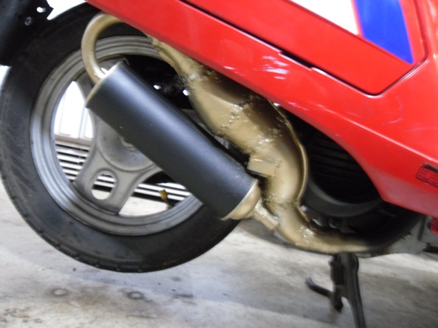

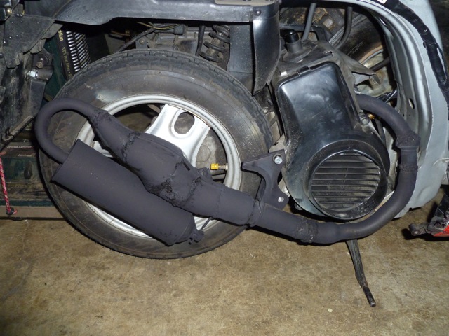

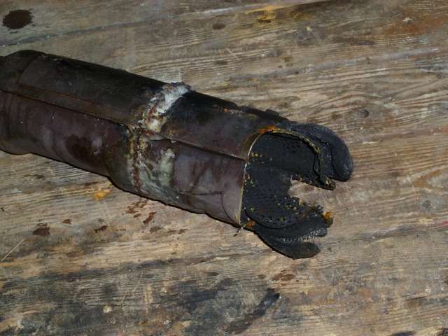

nice pipe how well did it work on the razz? i guess i should come fourth and just say that i found the widestt and IMO strongest powerband when i kept all of the original pipe but if you want a purely topend pipe you can cut and weld up near the header or right before the muffler so that if you want to go back to stock your muffler aint screwed like mine is :naughty: heres some pics of how my pipe used to look back when my stock jazz could beat the gold pipe aero off the line and what i did to the muffler for the better black pipe

i highly recommend making a larger glass pack muffler like the one i made which will be unbelievably quiet BTW and will give better performance than a baffled muffler but you don't have to make yours out of a brake cleaner can :geekdance: also having the stinger start about 4 or 5 inches into the expansion pipe helps quiet them down a bit too... i should just make a youtube vid about my pipe but then i would need to get an account and learn how to upload a vid :|
