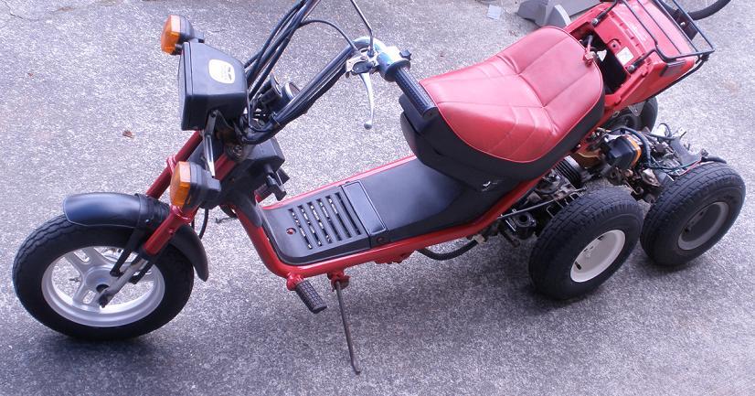

......hey mouse3wheeels....ever since you started this thread, the only pix of your trikes that I remember seeing are the recent zup-mobile....got any of the TG 50's :?: ....file photos will suffice....just curious to see your rides............ :hi:
Re: Gyro - general thread
Posted: Sun Aug 28, 2011 10:12 am
Old photo of TG50 near ready to ride. It was a former ocean beach rental. The shop welded kickstands on some of them.
Posted: Sun Aug 28, 2011 12:06 pm
....the kickstand probably became necessary when cables broke and owner chose the kwik-fix.....I had intentions of putting kickstand on my Cushman, but gave it to my daughter instead of letting it sit here and kill grass....seems the Nashville police preferred I not drive it around town anymore....no title....the extra motor sitting behind the gyro gives an interesting illusion.....rock-on..... :urban:

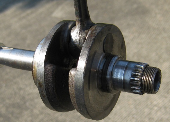

does anyone know if there are any scooters that use the same crank shaft or piston as the gyro?
Posted: Sun Sep 11, 2011 11:13 am
The crank is unique to the Gyro. The output side is very short and hollow, to allow the right rear axle tip to slide within to stabilize the axle. The axle tip has a needle roller bearing like the connecting rod.
Piston/Rings are easy. These will have a domed vs dished piston top, giving a bit more compression - Elite SA50 88-93, Aero 85-87, Elite SB50, Spree 86/87.
