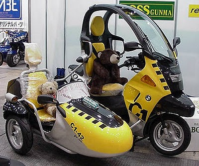

Here's a sidecar based upon that scooter 66Six posted

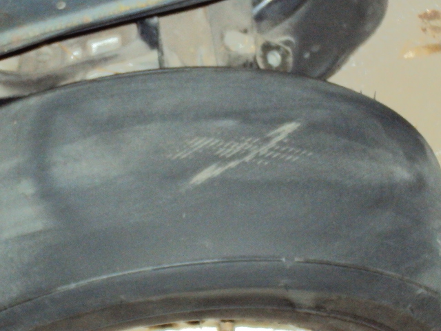

.....As tires go, the Kenda 15X6.00X6 that I have been running are good new but go away after 2-3 outings and are completely gone after 4-5....a bit salty @ $30 a pop....finding a rib-tread tire with thick rubber on the contact surface has been unsuccessful so far....if something looks good online, there's always shipping that makes it all too expensive...so if I buy locally, i'm limited to what I can find....no way will knobby tread work....slicker the better.....here's what todays' final laps produced....weeeeeeeeeeeee......... :coolcruise:
Re: Gyro - general thread
I know of no one who can wear out Gyro tires and have more fun doing it than you. Do OEM Gyro tires hold up any longer?
I've looked a Carlisle tires like this, but never bought any.
http://www.specialtytiresusa.com/greenb ... -00-6.html
First time out with gyro on track was on OEM tires...I was green and tires were old but had plenty of tread....no grip with OEM's...none...now that I've been on the wider, softer tires, anything less would be counter-productive...the link you shared was beneficial, seeing some brands and styles not previously found....OUT OF STOCK on the super-cheapo's...interesting model by Deetone...6-ply was bit of a shock but might be an advantage over the 2-ply I've been running....One more pair this year will get me through ,so I'll probably be buying the same tire @ Northern Tool....I wouldn't mind the cost if the tires lasted longer........ :urban:
