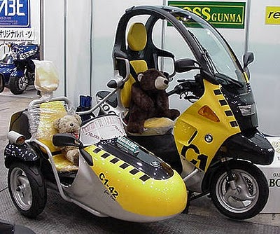

Here's a sidecar based upon that scooter 66Six posted
