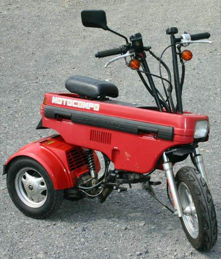

Here's a custom Motocompo found on the 'net. Short write up is at this link
MotoGyro 2.jpg (84.7 KiB) Viewed 8129 times

Gyro-compo :shock:
Re: Gyro - general thread
Posted: Mon Oct 31, 2011 4:33 pm
by gyromaniac
that is one awesome scooter made even more awesome
Posted: Mon Oct 31, 2011 5:54 pm
by eliteguy50
gyromaniac wrote:that is one awesome scooter made even more awesome
Two awesome scooters.

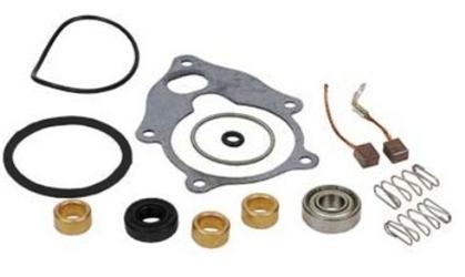

Beyond locating another Gyro starter, here's other options. I prefer the rebuild path
-- Rebuild --
If your armature is failed, it may be replaced with one from Honda models listed below. Spree armature's can work too. But be careful with the Spree, I have received a starter starter with a different number of teeth on the shaft. Then get new brushes/springs, oil seal and bearings which fit the Gyro/Spree/Aero/Elite (AF05's only) in a starter rebuild kit for a Suzuki LT-80 starter (see eBay, about $23). There will be serveral parts in the LT80 kit you will not use.
LT-80 starter rebuild kit:
