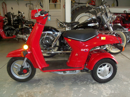

I am going to post proper sized pics of the complete 1984 Gyro restoration soon.
Kev

kev wrote:This is my 1984 Gyro with 250 miles showing. I hope I sized this photo right !!
Kev
Picture is so small, I cant see the awesome handiwork you've done. I know 66SIX can post pix that are the size of your house. You must have gotten this one running since it has 14 more miles on it than when you got it...I hope you haven't pushed it that far.....hahahahaha
