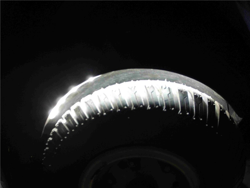

close up of the lights
- GOPR1341.JPG (59.92 KiB) Viewed 6268 times

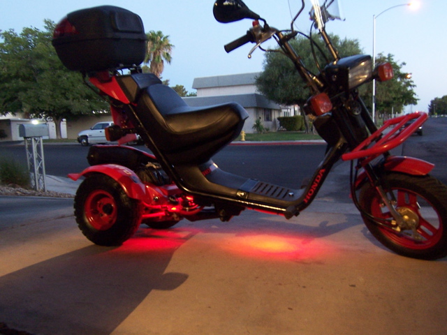

Re: Gyro - general thread
LED lights
- Try sticking them on a windshield ...
- 100_6582.jpg (20.9 KiB) Viewed 6262 times
- 100_5903.jpg (145.19 KiB) Viewed 6262 times
- 100_5878.jpg (150.25 KiB) Viewed 6262 times
Messin' around with my spare rear fender, adding some extensions for the wide tires. Work in progress...
Very nice fit...what did you re-purpose ? Looks like quad fender.....
$17 black ABS trailer fender. Cut one in half and trimmed up a bit.
The information in this post is priceless...it should be the first post in a new thread of "Tech-Tips for Gyro" instead of burried here in the General thread. ....siggy wrote:I know just what you mean. Spent lots of time pondering the rear wheel situation. I'm not using any adaptors..
It started with some eBay Suzuki LT80 atv rims. 1.5 neg offset 4.125 positive / 8x5.625 size. The set I bought had dual bolt pattern of 3/120 and 4/80. After dremeling off the three little locator tabs on the Gyro hubs, they bolted right on. The problem was they were sent drilled off-center. Not concentric. I had to re-drill them but the 1.5 negative offset was the key for Gyro application.
...the sweet thing about what you have done is the way the hump fit the contour of the lip and drop the outer edge down to an attractive profile...not some mud-flap-lookin' extension. Well, here's another one for the new thread, thanks to the siggy....siggy wrote:$17 black ABS trailer fender. Cut one in half and trimmed up a bit.

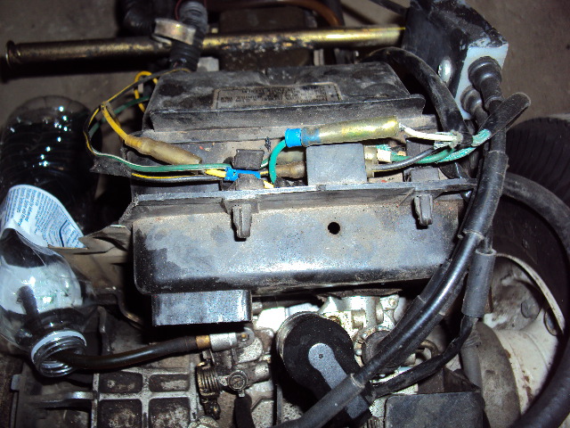

does anyone know if you could replace the gyros airbox with one of those small K and N airfilters and what kind of affect on performence it would have?
- gyromaniac
- Posts: 149
- Location: richmond
what would you suggest my plan of action should be if i wanted to put the KN filter on?
I'm pretty sure that the pilot jet is not removable in a gyro carb. If you use a K&N pod filter, and upjet the main, you will still be left with an undersized stock idle circuit without Wheelman-type modification of pilot jet.Following pix are for all to see, especially graphite9....
....pm me brandon if these parts will help you....
- Gyro parts 001.JPG (167.83 KiB) Viewed 6325 times
- Gyro parts 002.JPG (170.34 KiB) Viewed 6325 times
- Gyro parts 004.JPG (170.17 KiB) Viewed 6325 times

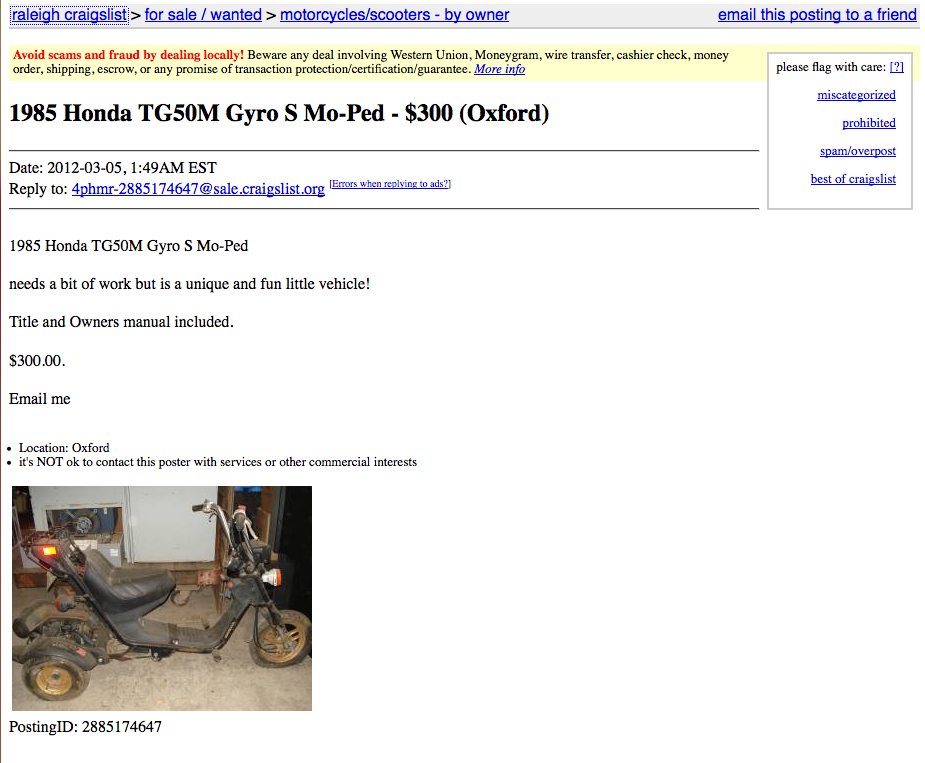

Gyro Alert $300.00 as of 3/8/12
- Screen shot 2012-03-08 at 2.13.29 AM.png (205.41 KiB) Viewed 6309 times
