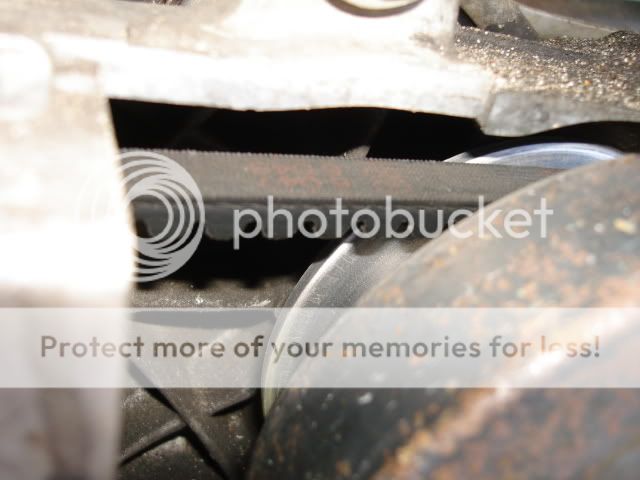

Here's a neat little trick I found to overcome the bogging from to amount of pulley mod needed to brake 38mph or so. 38mph(gps) is the speed at which I had to start lowering my idle speed to not engage the clutch at idle, because the pulley mod changes the engagement point of the rear pulley as it speeds up in relation to the engine. The result it has on takeoff is horrendous.
With 3k grab springs in a dio clutch and bell assembly swapped onto the stock spree pulley, it then became possible to take off without pushing with a top speed of 42mph (gps). It revs to about 9800rpm before running out of steam on flat ground. I think if I was willing to push the bike up to 10mph or so, I could go a bit faster, but the rear pully is almost bottomed out with the stock size belt.

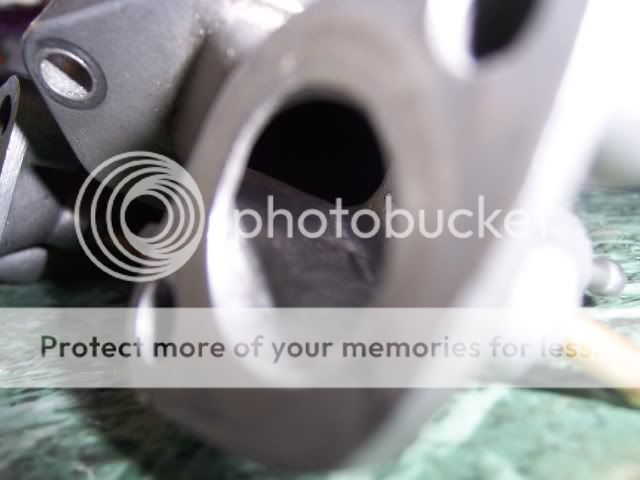

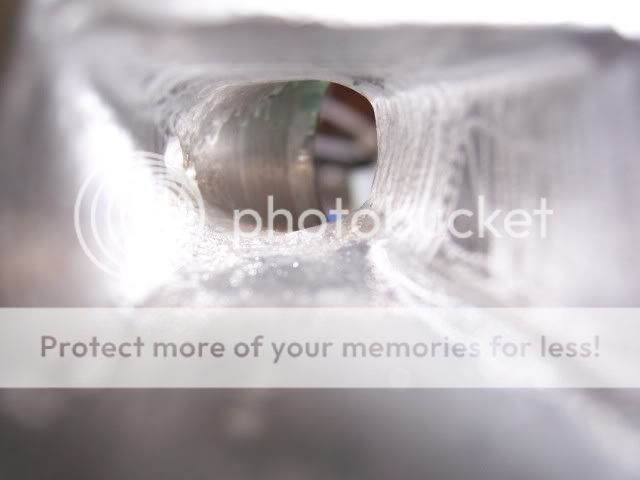

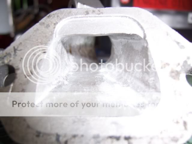

The intake is freaking HUGE!
Stock NQ50 intake:
My NQ50 intake:
Stock:
Mine:
Stock:
Mine :mrgreen:
Gaping maw:
And it had a good bit of portwork. (I should have taken pics of it clean, this was after 4000 miles of riding)
