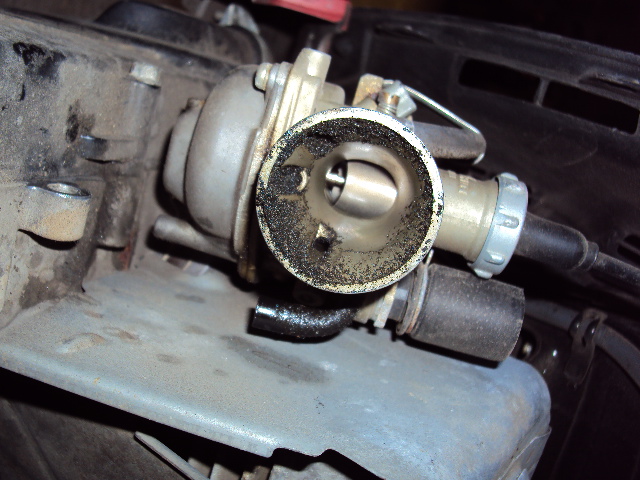

Time arrived to pull the carb and douche it good...my bad when I opened the airbox to find filter "remains" laying on the bottom....should have checked that first thing before ever riding it, instead, I clock 800 miles running slightly lean.and risky a perforated diddly-whumppit...note the coating of powdered filter foam lining the carb throat...... :surprise:

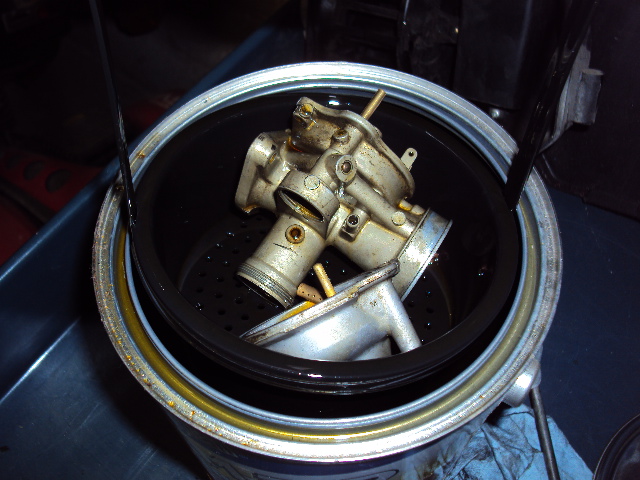

THE GOOD STUFF
THE GOOD STUFF

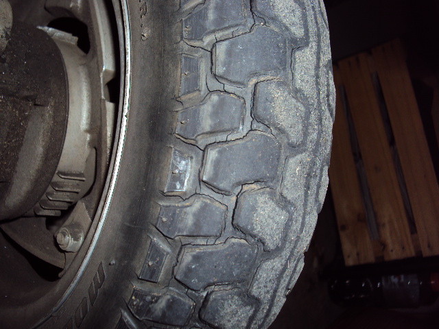

Found the main jet=105...pilot=40...since this scoot only had 891 miles when I got it, and it was running pretty good, the condition inside was mostly clean before the chem-dip....fired up and idled with initial settings...throttle felt much fatter and quicker, even without the filter....I'll get one on it before any real test ride...can't wait....rear tire, not happy, go boom any minute....just got paypal money for more new tires, thanx mark.nichols18
motormike wrote:note the coating of powdered filter foam lining the carb throat......
Ha - I like that pic! I had a scooter with no filter in the airbox, but would not start at all. A crumbled filter had lodged the reeds open and the previous owner had removed the filter because 'it was bad'. Easy fix, and was sorry the seller had not gone one step further (for his sake).
.....airbox cleaned, foam filter replaced, everything back together except the side panels....that tire has to go, and tuning always easier with no panels....only a short trip around the hood today, enough to know there is an improvement...tomorrow will take it to WOT for the real test....... :hi:

Motormike's photo showing the air filter problem is worth re-posting
-- Air Filter Bits --
  • Completely cover air feed for the idle circuit.
  • Almost plugged air feed for the emulsion tube
  • Bits of air filter can get inside smaller passages within causing further issues

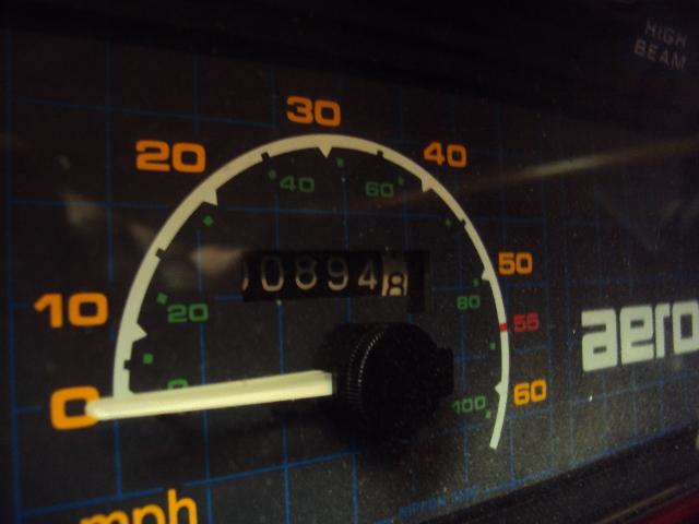

:urban: I mentioned a suspect speedometer previously. I tried a comparison with another bike that is deemed accurate. Control bike doing 45 mph compared to 38 mph shown by my Aero. 7 mph slow is a bunch. Makes me wonder actual speed when my speedo is showing 50 mph. Assume it would be 57 mph, give or take. I'll find somebody with a gps to do it right next time.
Never heard of a Honda scooter speedo reading low.
No bike speedometer is "accurate". The error percentage is as high as 12% on Japanese 600cc sportbikes. Harley-Davidsons come closest with 2-4% optimistic. Back issues of Motorcycle Consumer News.
Only Flash 3.26 with a 3.50 front Michelin is pessimistic, about 3% low due to the larger circumference of the tire.
