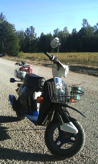

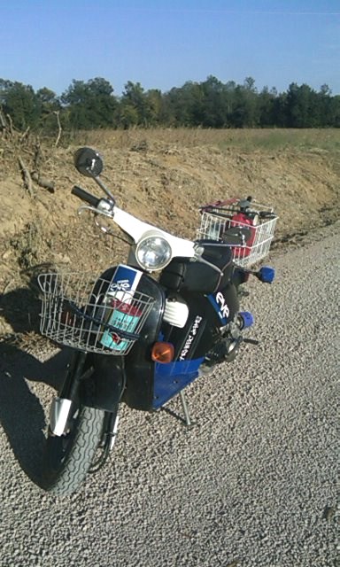

I took some pics of the Eve with the headset swapped on the "new" slagg paved road to my house which was until today gravel
No more dust, maybe I can wax this baby to a shine without worrying about it getting dirty so quick now
Now all I really need is a kickstand and this build will be finished ...for now

Re: My 86 Eve build
like the look but dump the front basket .. but she look grate love the 3 color look .. did good on eve..
Re: My 86 Eve build
hhaha I like the idea of a front basket even though the one i have on thee has been jacked up
someone bent it all up on the c70. I need that basket to put my cig tobacco in and any other goods I pick up when I am scootin. With the bigger carb I dont trust the small tank of gas to get me there and back so i always carry oil and a jerry can in the back. This build is utilitarian as much as anything. I want my ride to look good but I also need it to haul stuffffs
I have my tools, sidestand, jets, thermometer, cellphone and soda in the glovebox with a little room for something else
