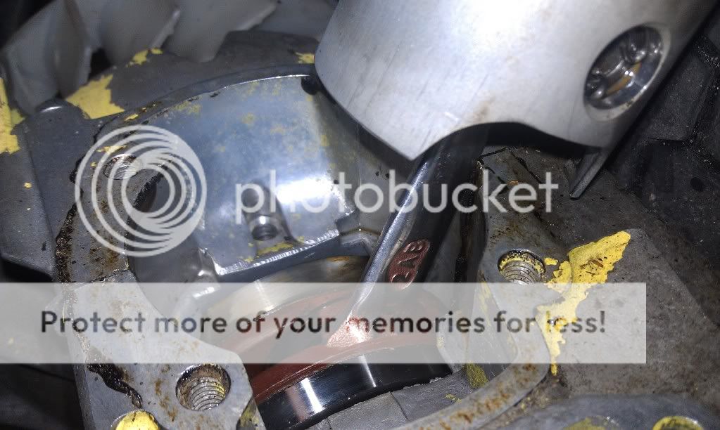

547 feet was the elevation no the distance.
It was fast.....not as fast as mine but it was quick.
I took the bore off and confirmed what I suspected.
Thats a ministroker alright.

Re: Looking for Scooter Mechanic in Michigan
that sucks
time to get the welder out

I found new Honda cranks for $172.95+shipping. It might be wasting $75 but I'm tempted to buy the new crank and have you install that and leave the other stuff alone (and keep the ministroker crank for another who knows what/when project...).
And regarding the second picture (the uh-oh or oh crap pic that's going to require some fixing), how much for that?
You can search around for a better deal on the stock crank than that. you can get a reinforced crank for less than 100 bucks new with seals and bearrings on ebay. If you are gonna spend money think about a malossi crank
Everyone loves polini but you COULD consider a ministroker bore that you might be able to get for less than 150 including piston head everything you need to rebuild the top OR since you have all the other stuff you can get the 80cc bore kit from autotech with a v8 pipe for around 250 LOTS of options

The ministroker works good with a 50mm bore.
Not so great with a stock bore.
The flange on the polini bore still holds the exhaust stud. So its not really a big problem,unless it breaks more
If you want to keep the mini stroker, I would just buy a used bottom end with stock crank. Think about the math, 175 for new crank plus 40 for bearings and seals if they can't be reused. Plus 100 for labor. That is $300. When/if you decide to do a ministroker later, that is another $100 for labor. So if you took that 400, you could buy a stock engine for the polini bore and a ministroke bore for your current bottom end.
