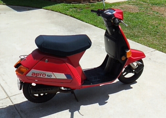

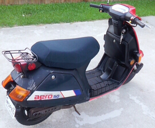

- Left side
- 2014-05-18 07-51-10-305-1.jpg (171.37 KiB) Viewed 8203 times
- Quick ride
- 2014-05-18 07-51-31-568-1.jpg (191.58 KiB) Viewed 8203 times
- Right side
- Screenshot_2014-05-21-00-34-58-1.png (46.58 KiB) Viewed 8203 times

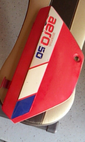

Some plastic pics
- Left panel
- 2014-05-22 05-18-15-695-1.jpg (100.37 KiB) Viewed 8176 times
- Right panel door
- 2014-05-22 05-18-23-008-1.jpg (171.14 KiB) Viewed 8176 times

Probably just spark. Got 2 coming in the mail. Reeds looked great, shiny, opens &closes great. Anyways, this is how she looks.
- 2014-05-23 11-18-12-420-1.jpg (207.63 KiB) Viewed 8165 times
- Right side
- 2014-05-23 11-18-22-725-1.jpg (169.38 KiB) Viewed 8165 times
