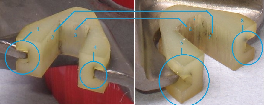

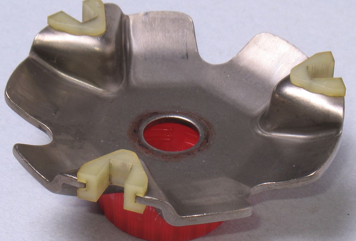

bajack wrote:I sure could use some pictures of someones slide guides about right now..
Here's OEM parts at ~3k miles:

I do not see enough detail of the failure from your pics to comment, yet post opinion, and pics in case it is helpful.
-- Arm chair troubleshooting
IMHO, Honda designed the Variator/ramp plate and guides such that worst case, there is no bind between the ramp plate to guide seat and the variator splines the guides ride on. Centrifugal force will force the guides outwards. Thus they should only wear on the variator side, with design tolerance giving an air gap on the inner side of the guides.
Possible sources of Damage to the guides inner surface:
  • Worn hole dia in the ramp plate
  • Wear or excess slop in the variator bore -> variator bushing wear.
  • Undersized or worn spacer which the variator rides upon on the crankshaft
  • Worn crankshaft dia in the area of the ramp plate interface
-- Supporting data: Wear at 3k miles on inner surface of guides
I looked for inner guide surface wear, yet see *zero* wear on the posted 3k miles parts.

bajack wrote:is that both sides? looks like that? this was only happenning on one side of my guides.
Oh, I thought you wanted the inside edge, because the first set of pics showed little wear at points labeled 1,4,5,8.
Here's a pic of each side. There's not much wear on the plate/guide surfaces
