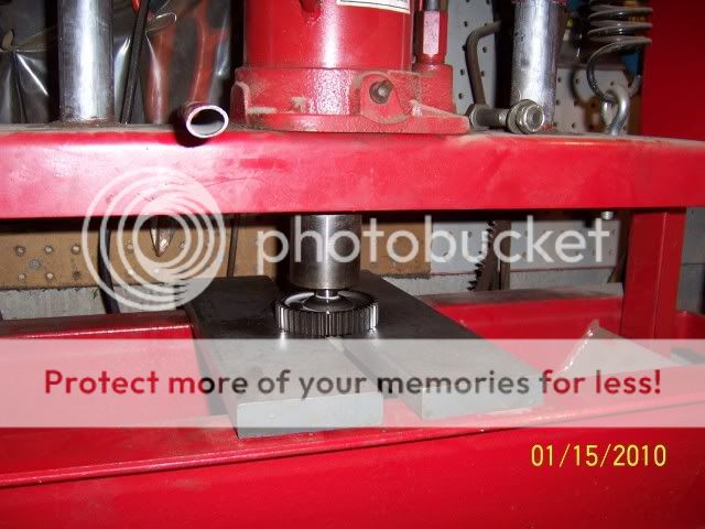

pressing gears is pretty easy.
Here are some pics of my first time doing it.
sprayed it with WD 40 and put it in the press.

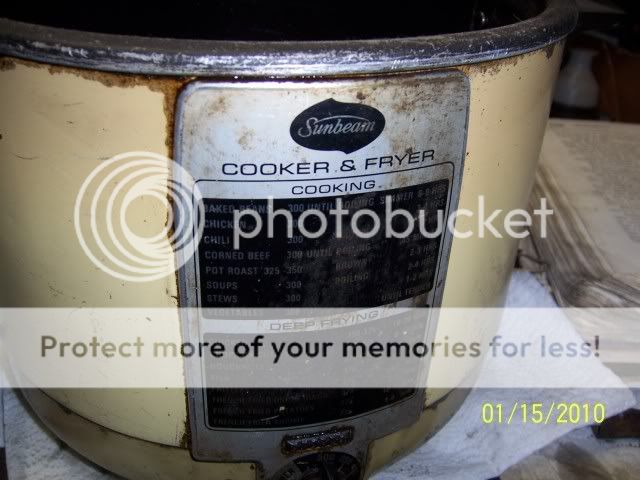

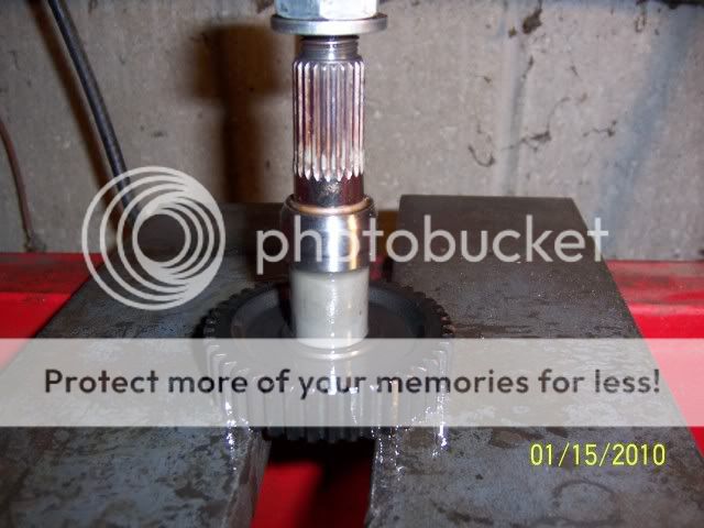

What a stubborn piece of S**t ! Time to put some heat to it. Torch? Oh no no no...that's not my style.
Go to the kitchen, get the fry daddy , get some castrol 10w 40, Set it for abou 350-375 or "pot roast" if your cooker has this setting
Soak your stubborn gear and shaft for about 10min. Return to the press and try again.
Bam! like butta baby! And just like that It came out. And no torches to OVER HEAT the gear
Now make sure you wash your fryer out really good before you make jalapeno poppers, at you next party.

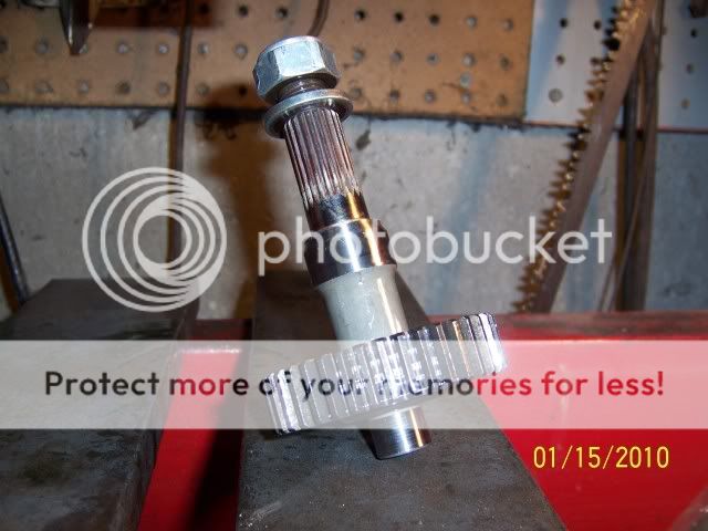

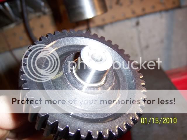

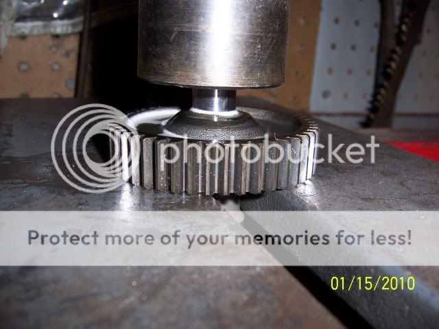

I gave the new gear the fry daddy treament before I even tried to press it on the shaft. It worked very good.
The new gear went on with no trouble.

Much obliged for the share TJ. Putting on the nut to protect the treads and provide a more stable press surface is a good idea I hadn't thought of. I think I'll give it the WD-40 or deep fry treatment now.
